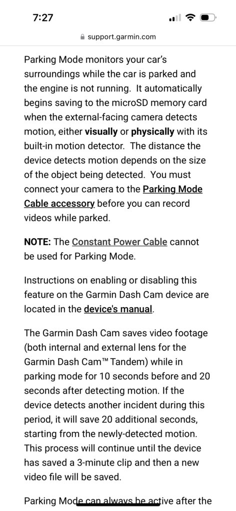

    Edit: nvm seems the mini2 and onward should function with the constant power cable based on reports i read. Apparently it bases it off inactivity/no motion.

    The attached file in post #7 says the Constant Power Cable will not enable the Parking mode.

    you need the parking mode cable
    https://www.garmin.com/en-US/p/587564

    Parking mode cable is “required” to record when parked.
