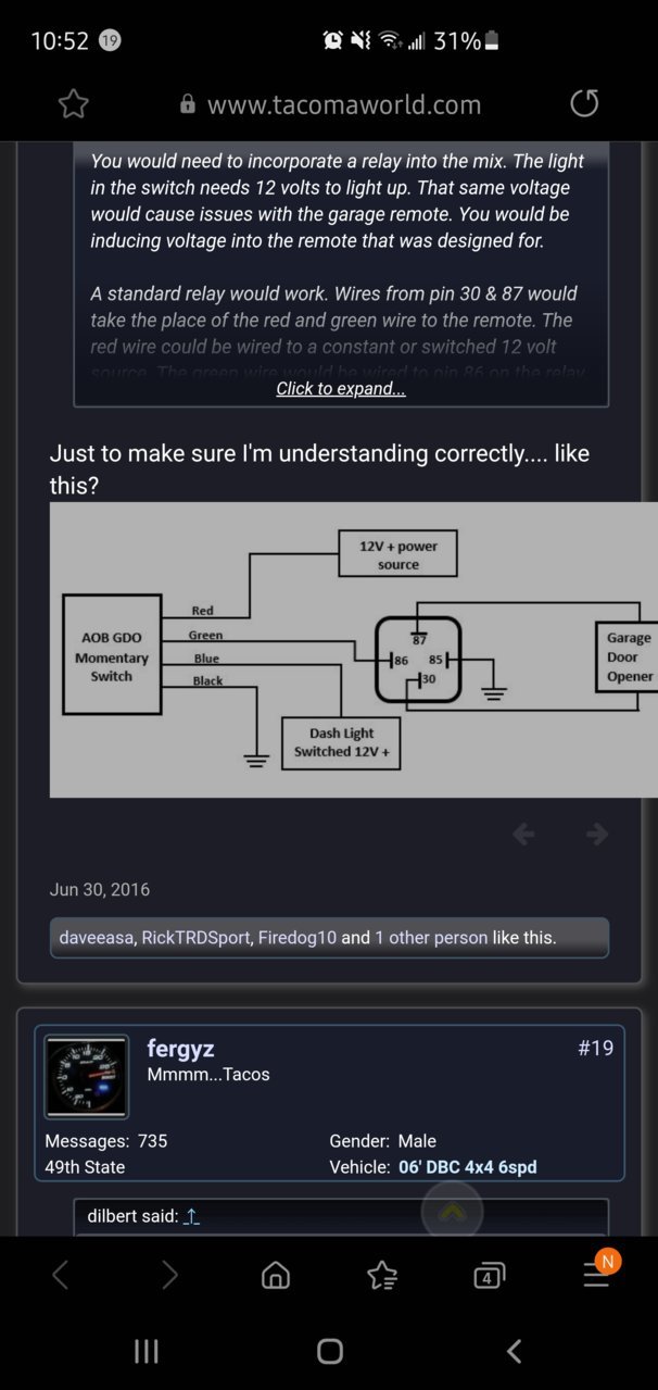

    Okay,
    I have gone through TW in hopes to find a step by step on how to wire a garage door opener to a oem style momentary switch, but all of the threads get bogged down in weird things.
    I'm looking to wire a garage door opener to a fused relay and an oem switch. I found a diagram that explains it off TW, but I have 2 questions. Where does the 12v and the dash light leads go?
    Different question- really want to wire 2 buttons off the remote to a single switch (DPDT)- would the included photo be the same thing or would I need two relays?
    I am not experienced with this type of stuff so if you can be simplistic that would be awesome.

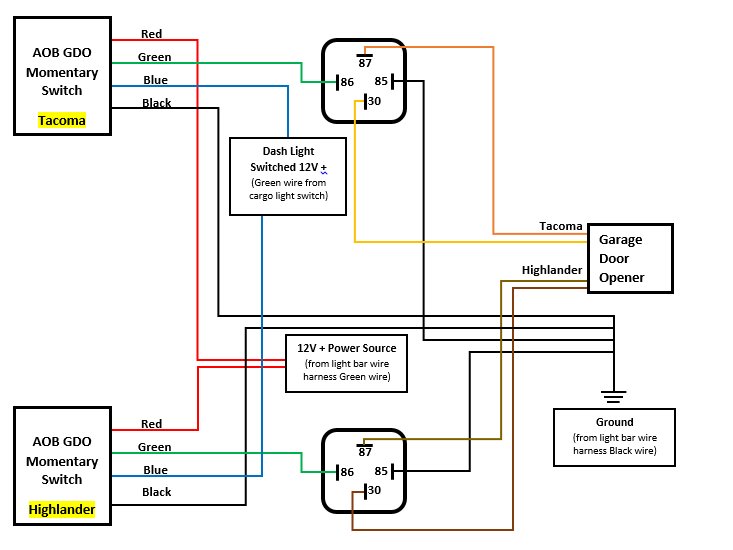

    Here's how I did it with two switches to open two doors. I've since switched to the homelink mirror and it's great.
