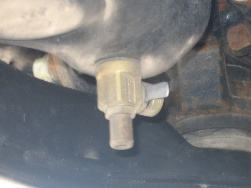

    Installation is easy. Just remove the drain plug when you change your oil. Clean up the area around the hole and install the fumoto. Tighten it the same as you usually do with the plug.
    Here it is installed:

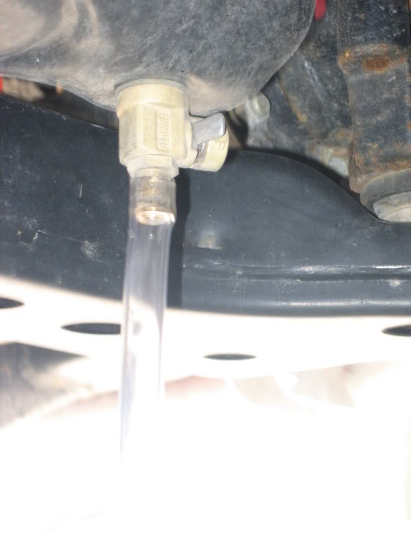

    It takes a 3/8" ID hose. I purchased at Lowes for $.25/ft. With the hose attached:
    Put the hose directly into a container (I used an empty window washer fluid bottle):
    You open the valve by moving the tab. It needs to be pulled in and pushed down to open. The oil flows out fairly slow so begin working on your filter once it has begun draining. You may also want the oil to be warm. When its done draining, push the lever up and close the valve. Properly dispose of the oil (I take mine to Advance Auto and they recycle it).

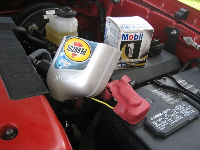

    Add oil and your done:

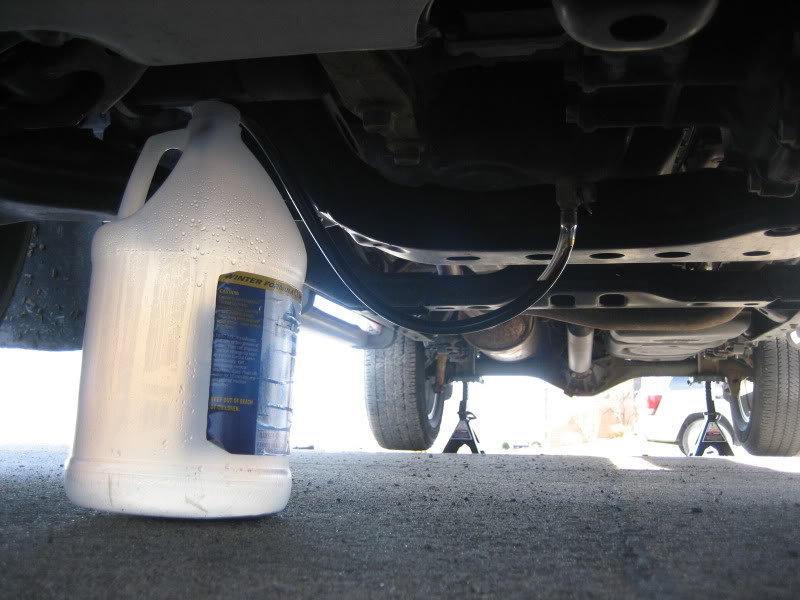

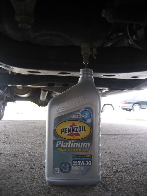

    It is also possible to dump the oil directly into the container - no hose. The height of my stock 09 TRD Sport allowed for an empty quart of oil in there:
    I used a short segment of the 3/8" hose to attach it to the overflow drain below the oil filter. I ran that down into a container under the truck. For the 1st time in 6 years of changing my own oil, I did have ONE SINGLE DROP OF OIL on my driveway! It has never been so easy and so clean. No tools necessary.
