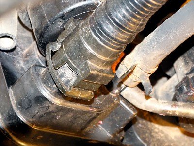

    Anybody know how to disconnect this? Trying to replace my fuel pump and this is the only thing holding me up.
    edit: this is for an 02 tacoma.
    Pic attached

    The whole thing turns, what part twists and what part isn't suppose to twist?

    Just so everybody is on the same page, this is the image of the hose.

    Cannister fitting is male.
    Hose is female
    Whole hose end turns
    I can't find pix for end shown in your pix but this may help

    Follow steps D 1 2 3 in my previous post

    Squeeze and pull at the very edge of the end.

    Both sides were the arrow is pointing and pull at the same time.

    Sorry for not updating but that is indeed what I did, I pushed the hose in, pressed at the end and pulled it out. I was done around 1pm, I think, and started working on the fuel filter after verifying that the truck started up. Was done with the filter, took it to get filled up and drove around to make sure no issues. I do notice my startup is a bit quicker so that tells me the pump was probably on its way out. Thankfully got done for the evacuation but it looks like I'm stuck like chuck.
