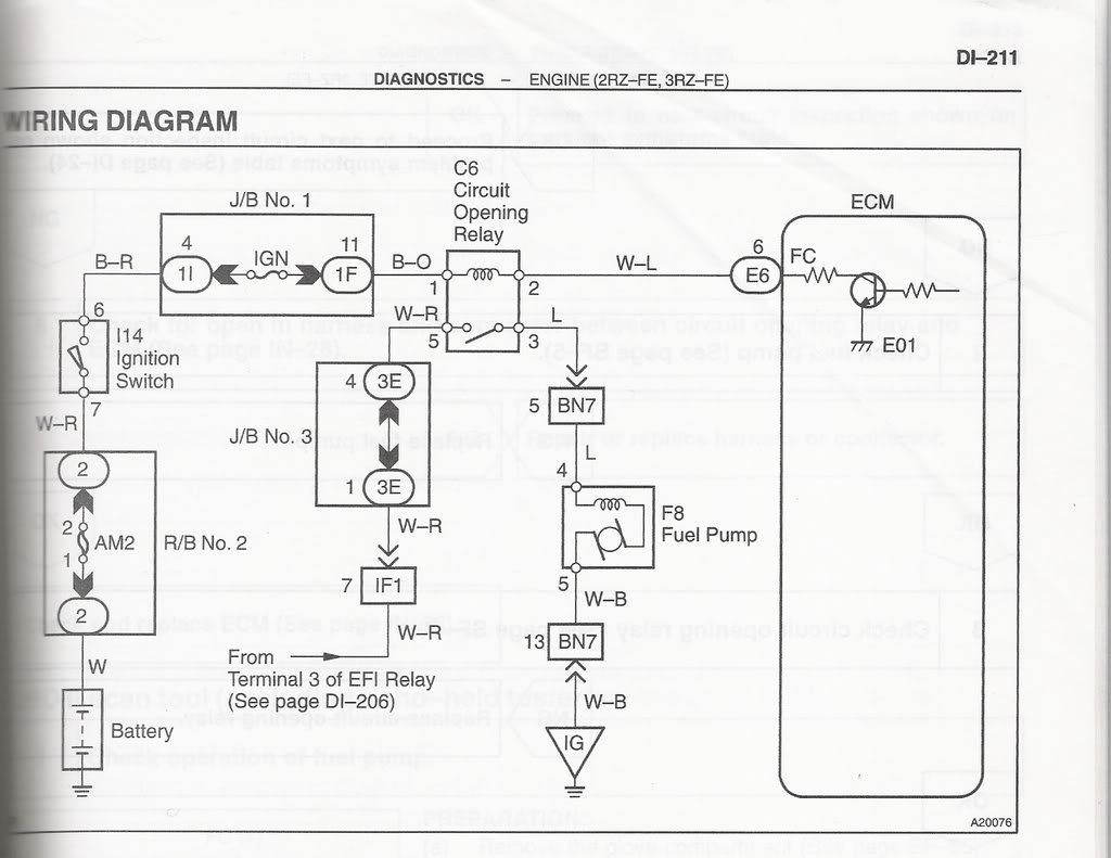

    @Dalandser I copied over their post, with the photobucket pics fixed:
    Simple Fuel Pump Kill Switch I installed on my 2003 2RZ. I'm pretty sure this procedure will work on all 2001-2004 models, and it may also be applicable for 1996-2000 model Tacomas, but cannot say with 100% certainty.
    I put a simple 35 Amp ON/OFF Toggle Switch (NAPA PN TG6057) on the Blue Fuel Pump Power Wire at the Circuit Opening Relay (C6). It's the wire that is labeled "L" at terminal 3. The minimum Amperage rating of the Toggle Switch should be 20 Amps, but it doesn't hurt to go with one that has a higher rating.
    As you can see, the Circuit Opening Relay supplies power to the Fuel Pump via the Blue wire when its Normally Open (N/O) contact is closed. The Toggle Switck "opens" the Blue wire when it is switched to the OFF position. This, of course, prevents the engine from running by killing power to the Fuel Pump.
    Fuel Pump Control Circuit.
