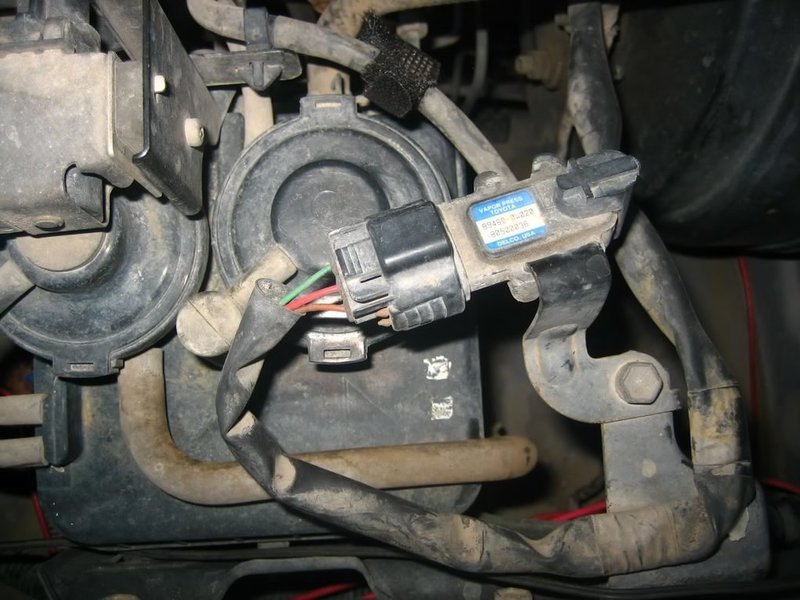

    I need the location of the 01 tacoma 2.7 fuel pressure sensor
    the picture that mountain forest posted in 2014 no longer comes up.
    He says its located in the engine compartment close to the drivers side fire wall
    can anybody be more specific?
    Thanks

    License2Ill,
    Thank you for the picture man!
    It looks like the sensor is just in front of the master cylinder. Is that correct?
    Thanks again
    Raderfan57

    That is the correct location just in front to the right of it, I found one at Auto Zone for the Tundra but worked just fine for my 01 Tacoma V6 #89460 - 0C010 Vapor Pressure Sensor.

    This may be a stupid question, but where is this picture taken?
    Is the evap pressure sensor switch behind the driver side rear wheel or under the hood?
    Thanks in advance.

    Under the hood, drivers side just above the brake booster.
