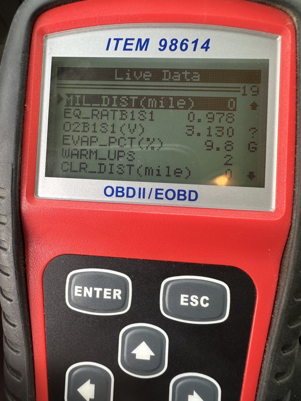

    I’ll have to take the TB off and clean it. I know it was done at least a year ago but how good the shop did. Here’s the live data I pulled from the scanner. Running out of daylight so I’ll have to start again tomorrow.

    Well we definitely have an issue, your at -25% fuel trim.
    I'm thinking first clean the throttle body and MAF sensor and see where that get's us.
    Need to let it run longer so the downstream O2 sensor comes online so we can make sure the upstream sensor isn't lying.

    Cleaned MAF and TB last night. Let everything sit overnight to make sure all was dry before putting back together. Here’s the results from running it. What line is the downstream sensor located?

    Downstream O2 will be O2B1S2.
    It looks like your MAF sensor is over-reporting, we typically look for Grams/Second to be about equal to engine displacement in Liters at a hot idle.
    You have a 2.7L engine so you should be around 2.7 g/s (0.357 lb/min) but your at 0.623 lb/min (4.7 g/s) which is almost double.
    Are you running the stock intake system?

    I did have a p0172 CEL now with the misfire codes. Seems the next logical step would be to run the truck to get that downstream 02 to come on, Then compare numbers.
