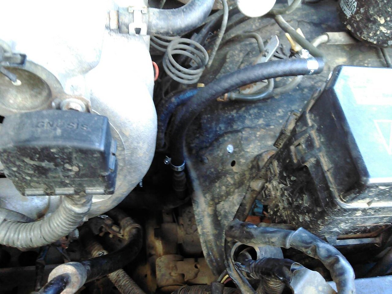

    So the other night, I went to start the truck, and it started, but died immediately. After that, it would crank, but not start. Sprayed some ether and it would run as long as you kept spraying, so definitely a fuel problem. I took my dad's car to go get a can of gas just to make sure I didn't run out of gas, because my fuel gauge does not work. When I got back, I saw that my dad had undone a fuel line to see if the fuel was spraying or not. I took the tail light relay and put it where the fuel relay goes and started it up, no problem. Okay, $9 plug and play issue, right? Wrong.
    When my dad undid the fuel line, he stripped the nut on it so bad that even vice grips weren't able to hold it. So the line had to be cut.
    I figured it wasn't too big of a deal. I could just buy a new fuel line and connector. Wrong. Only people around here with the right parts is the dealership. And they want $135 for it. I can't afford that, so I'm trying to rig something up.
    My question to y'all is can I simply run a rubber hose and clamps, (part of it is already rubber hose) or is there too much pressure running through the line for that? What would you guys suggest?

    yep just unscrew the nut but don't cut the line, you want the flare on it to give the hose something to hold onto for added security.
    since you are doing this you may as well do my fuel filter relocation mod while you are at it and then you wont have issues trying to access the fuel filter under the manifold which may be your problem. see it here: http://www.tacomaworld.com/forum/1s...diy-2-4l-2-7l-fuel-filter-relocation-mod.html
    you can just cut the rubber line at the base of the fitting and slip it over the fuel line and clamp it on

    This is what I'm doing for now, Hoping it will hold. It should.

    dont forget that its a high pressure line, so not sure how long the rubber one would last, make sure to use at least fuel line and it should be ok.

    It is the rubber fuel line they sell at Advance. Part of the original fuel line was rubber hose anyways. Anyone else done this before?

    its fine, the original line was crimped on. you just want to be sure to use a good quality reinforced fuel line (you see the string reinforcement threads inside it) with a good fuel line rated clamp and not a cheap regular rubber hose is all he was saying.

    10-4, yeah, it's good stuff. Even used a flair tool and flared out the two pieces of hard line before putting the line and clamps on do that there's even less of a chance of an end popping off. The clamp will stop up against that instead of just popping off.
