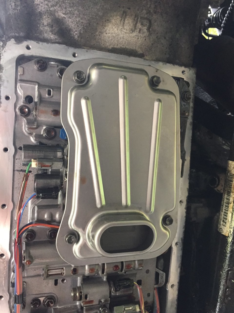

    I've done 4 DAFs on my rig. The sky did not fall, the sun came up the next day. And it's not really anymore more difficult than an oil change.
    I made an OBDII jumper to make putting it in "temp check mode" easy.
    I'll continue to do one about once a year or about 15k miles. I don't buy into the "cover my eyes and saying heck with it, it's a lifetime fluid". My truck...my money.

    Do it yo self. Kinda cool to see the inside of your trans.

    As I get closer to a 100k miles, one of my DAFs will include a pan drop and filter change. :thumbsup:

    Nothing to it, just remember the torque specs are in INCH/lbs. Not Foot/lbs!!
