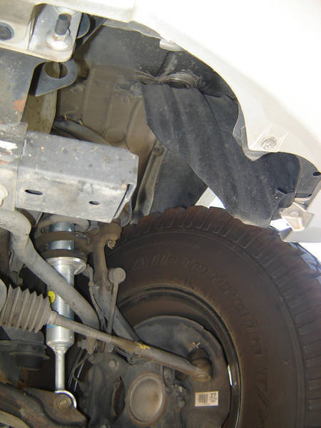

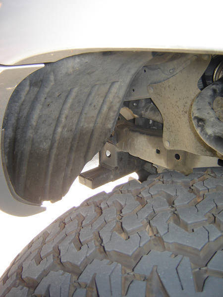

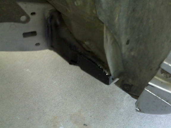

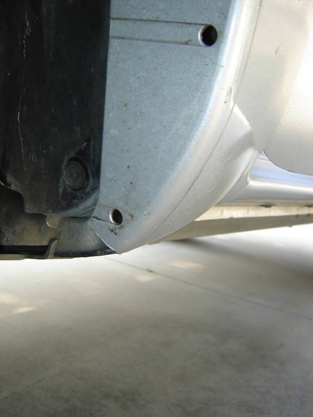

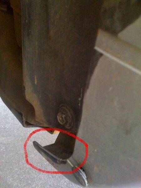

    So after reading/replying to all the posts about where and how much needs to be trimmed from the front wells to fit 285/33 tires i decided to make a thread about it. Maybe this could be a sticky.
    Here are a few pics i took a while back. All pics are from after the trimming was done. Sorry i don't have any from before the trimming, but from looking at the pics and looking at your wells you will be able to see the difference. Trimming may vary depending on where you rub/hit.
    EDIT
    Thanks to Nick (MyToyTaco) for providing before pics to show what and where you would cut/trim.
    Hope this helps!
    Pics
    Before Front Wheel Well Inner Plastics
    After Front Wheel Well Inner Plastics

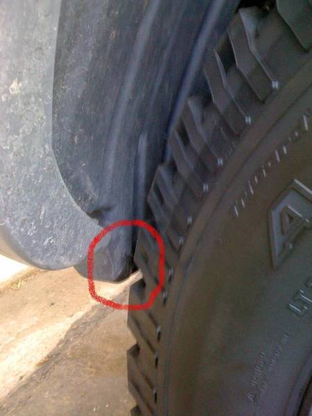

    Before Lower Rear of Front Fender
    After Lower Rear of Front Fender

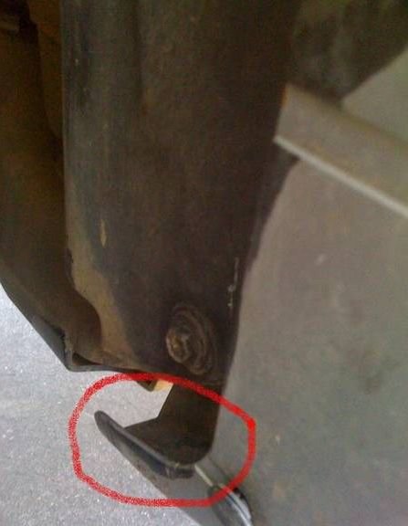

    and here are pics before trimming, just in case you want to add them to your post..

    For the cab mounts I went to a reputable local shop here in Temecula. They knew and have performed cab mount chops on other Tacoma's as well as Tundra's prior to mine. It was $150 for 2 hours of work. I think Demello does them for the same price.
    As far as your front inner well plastics and fenders, it's nothing that a dremel can't take care of. Just use some blue painters tape (makes it so cuts/trims are nice and straight) to mask were you wanna cut/trim and start cutting/trimming.

    No prob! Definitely gonna add your before pics. Will help others to see exactly where and what needs to be cut/trimmed.

    I just installed 285/75/16 BFG MT KM2, but so far I have no rubbing in the front liner. I had rubbing at full turn at the back fender so I just cut the plastic per your picture.
    Do you know what is your truck's left/right caster? Mine is at 2.4 degrees following Toku's recommendation. I'm curious why I don't have to do trimming in the front.:cool:

    I have a print out of my spec in my gallery, but with the specs on the caster, it made my tires sit back more in the wheel well and rub the cab mounts. Thus resulting in chopping my mounts.
    I had a re-alignment not to long ago and the specs on L/R were around 1.2-1.5 IIRC. Still sits back more in the wheel wells but not as much as before. I still rub some on the rear of the front fenders on both sides on certain inclines. Will be going to a different shop to get the alignment done.
