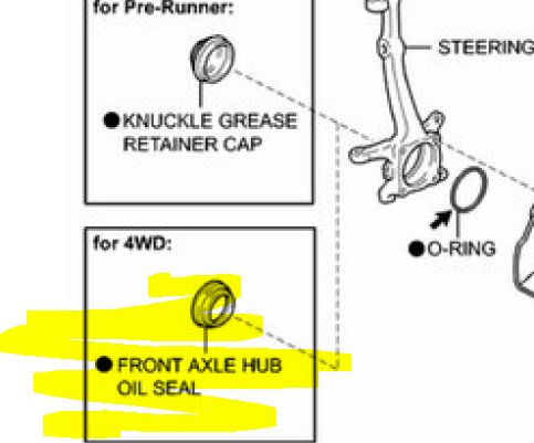

    I just removed my front wheel bearing assembly on my 06 taco fwd to replace it. I don't see any kind of gasket or o ring behind it. Is that right? What happens if there isn't one? I don't see anything leaking

    See attached pdf

    Wondering why there wasn't one on it. Does auto zone have those o- rings? Anyone know

    I replaced the hub assembly and still having a growl front driverside. There was a spring-loaded seal behind the hub assembly in rough shape. Did everyone replace this with their hub assembly as well?
    Edit: Here are the part #s
    "Credit
    @DaveInDenver
    For prosperity, CV axle dust seal Toyota part numbers for 2nd gen Tacoma are, going from outside to inside:
    Back of spindle: 90316-A0001 (Timken alternative 710573)
    Outside CV axle: 90304-A0001
    Inside CV axle: 41336-04010
    Outside of Diff:
    $10 90311-47027
    90311-47027
    (DS) and 90311-47026 (PS) "

    Did you ever find out if that seal (front axle hub oil seal) needed to be changed at the time of replacing the hub assembly?
    I’m about to change my hub assembly and wondering if this is something I should also do/look out for ?
