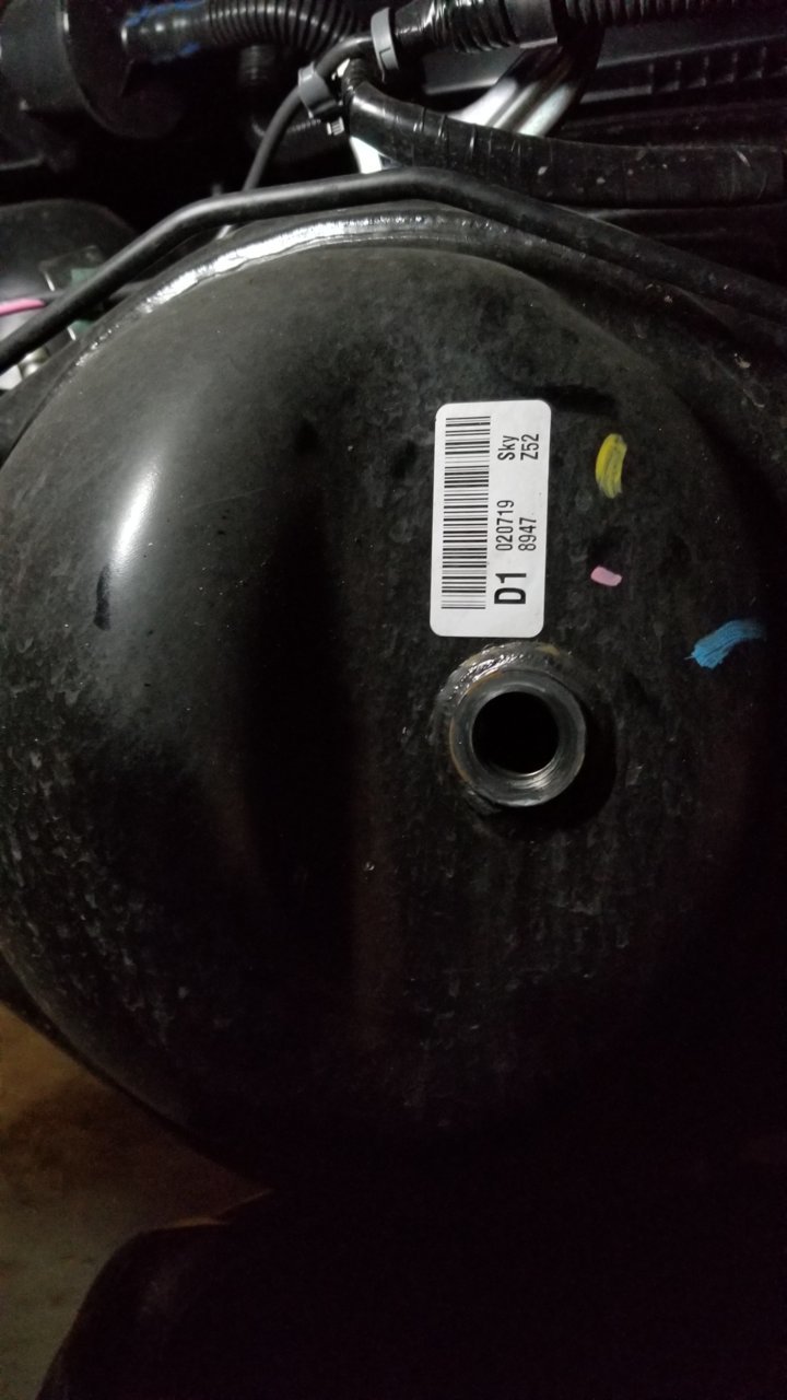

    When you drain your diffs there is still gear oil inside, it will not be the dry measurement when refilling. Don’t ask why I know this. I put 4 in the rear and 1 in the front. But I have a locker in both. If you over fill it it will leak through the breather.19B3594D-6919-458F-AC99-E125BFB04492.jpg
