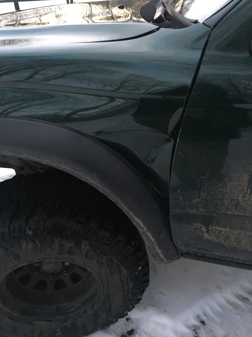

    I’m gonna go thru the same process soon to, there’s supposed to be one bolt under your headlight and behind the filler panel just above the bumper.3F0B348F-4FB0-4468-A5F6-014D7C3456E9.jpg
