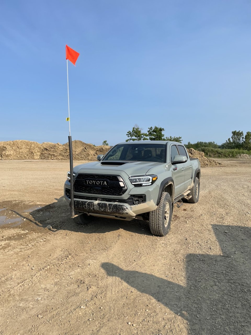

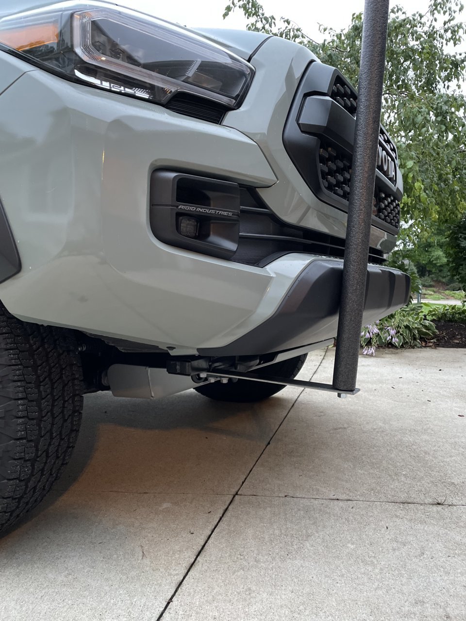

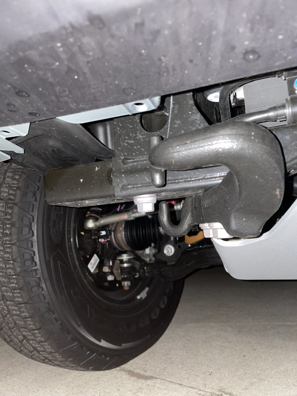

  16. Jul 21, 2021 at 6:18 AM
    #16
    Philly_
    Philly_ Active Member
    Jun 18, 2021
    #369016
    38
    Detroit, MI
    2021 Lunar Rock Tacoma TRD Pro
    I just did something very similar to make my flag mount for Holly Oaks. They now have the same flag requirements as the dunes. I used 3/16 flat bar I picked up from Home Depot, cut to about 17” and drilled two 1/2” holes. I used the single bolt that holds the crash bar extension on next to the factory tow hook.
    Held up great at Holly Oaks and I smacked it around pretty good! Had some steep declines and put it in the dirt more than once without the mount ever moving. Although, I do have a cheaper flag I picked up at Holly Powersports. My buddy had one from Duneland and the quality wasn’t even close. Mine worked great, but his was definitely nicer.
    taco kai likes this.
