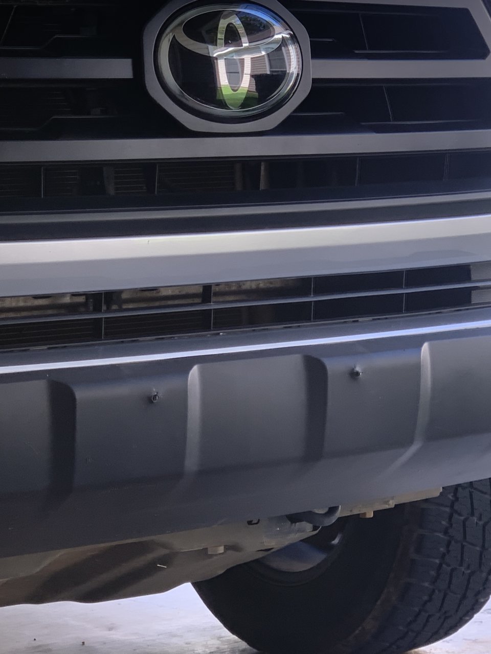

    So I live in a state that doesn’t require front license plates, yet previous owner (who was from same state) or dealership drilled holes in my front bumper for one. Can I buy just the black part of the bumper and it pops in place with clips perhaps? Can not stand the holes

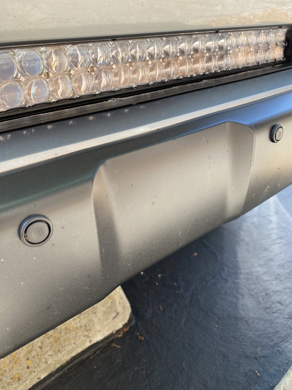

    I stuck a couple of those tabs that are used to keep plastic panels together…upload_2023-7-18_15-29-35.jpg

    and they look like sensors. not a plug. ive a set of dress up bolts and washers on my ARB bumper that the prior owner drilled in.

    Ha! You’re right, they kinda do look like sensors. This is what they look like…upload_2023-7-18_19-6-1.jpg
    I drilled a hole with a 5/16” bit & tapped them in.

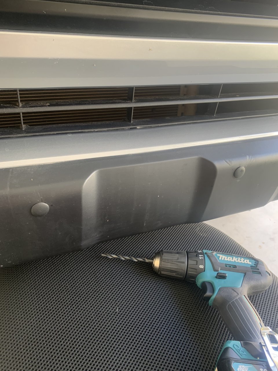

    Update! $6.99 fix, glad I didn’t spend $28+ on those fancy plugs (if I had a non black plastic bumper it would be worth it)
    Spurick Set of 4 Bumper Plugs Front License Plate Holes Cover Clips, Plug Bumper Holes for Chevrolet Dodge Buick Ford Honda Toyota, etc https://a.co/d/cK286FZ
    My screw holes were too small for these so I drilled em out with a 1/4 bit and used a box cutter to clean the edges so the plugs would sit flat.

    Nice fix. Mine is new, have not drilled it yet. I'm going to see if I can figure out a way not to drill. Maybe I'll just risk the tickets.

    looks great .....send me the 2 leftover
