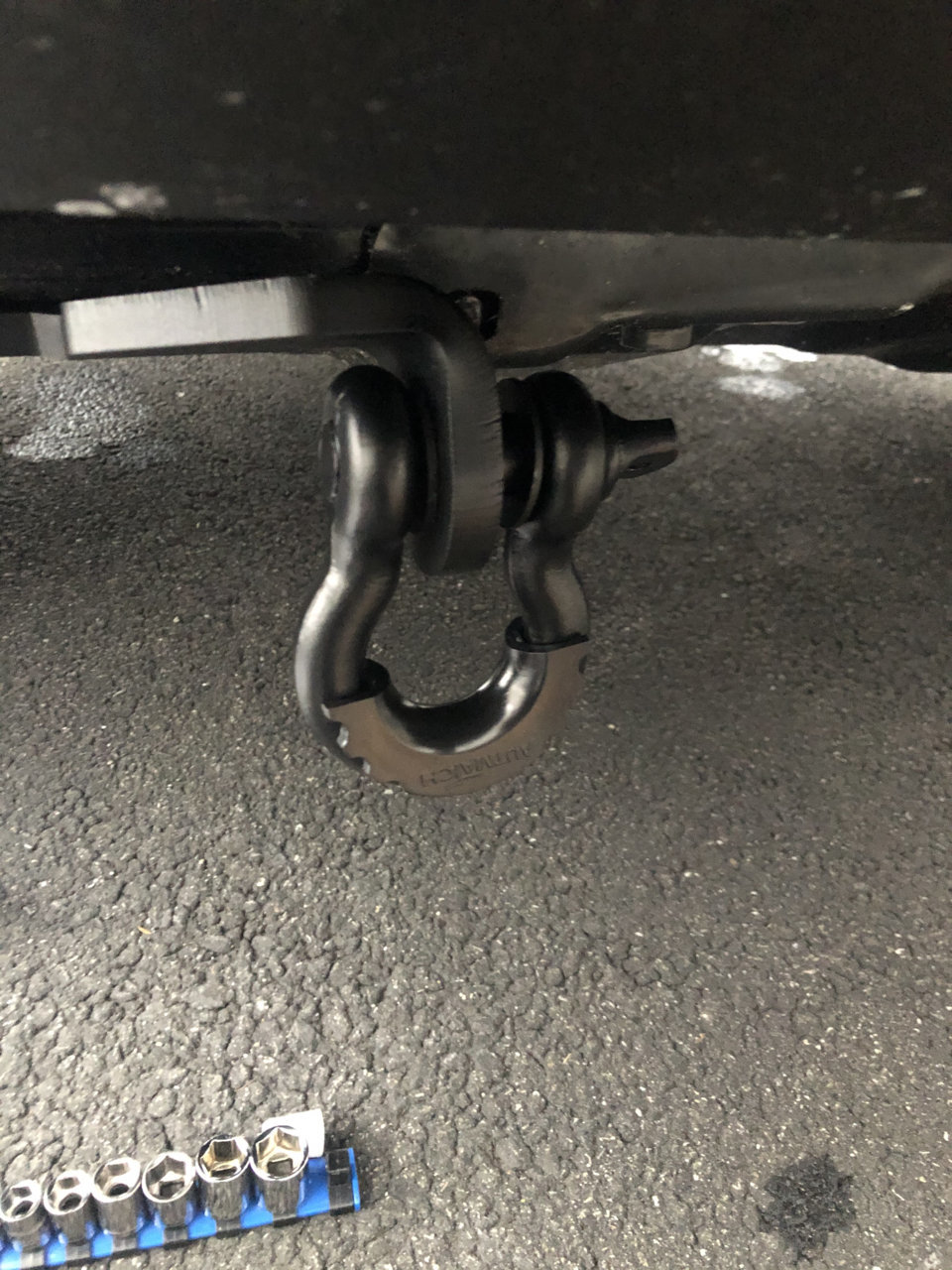

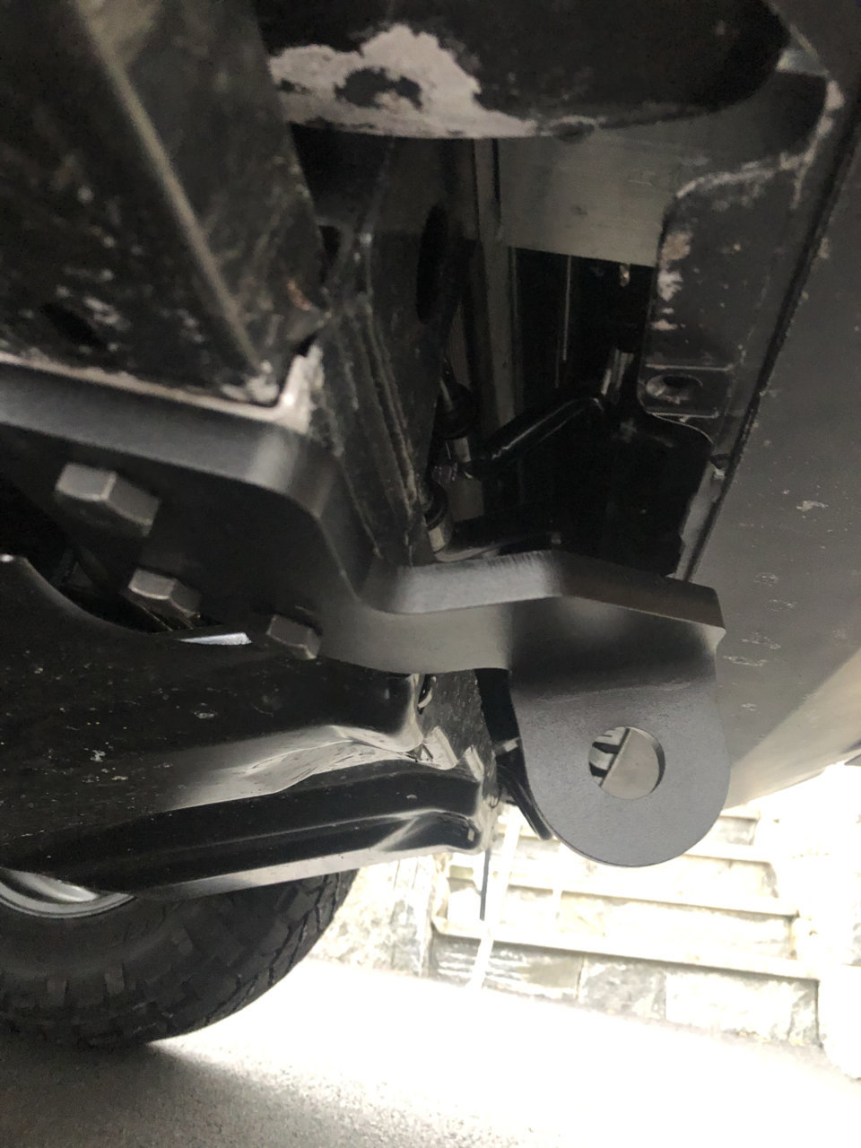

    I thought I would post this here in case anyone found value in it for future reference.
    Finally installed my BP Fabricating "Tacoma Recovery Tow Hook." A few general comments: 1) The product is well made and priced very reasonably for what it is. 2) The company is great. Fast shipping and very nice people. No issues. 3) Very easy to install. Probably took me 30 minutes total and that was because it was so cold. I have limited to not great mechanical skill sand this was a super easy install. Also keep in mind, I am not doing full on, aggressive recovery with this hook. I am doing very simple pulls -- most people stuck in the snow; slid off the road, slow and straight to fairly straight pulls. If I needed to do full on, what I call real, recovery with side pulls and lots of torque, I would get the ARB solution which bolts to the frame.
    Overall, for my needs, this is exactly what I need. I will combine this with a hitch receiver and that should more than suite my needs.
    Key steps:
    1) Remove the two screws holding the tow hook. Then remove the third screw which is holding the end bars in place. Side note: Seriously Toyota? You couldn't come up with a more elegant solution for those end caps that attach to what I think is the sub frame?
    2) Put some thread locker on your screws and hand tighten the BP Fabricating tow hook. It fits easily. Note: The screws don't come with tow hook so you will have to pick them up from a speciality hardware store. I found them easily and they were $1 per. The exact size you need is on the BP Fabricating Web site. Tighten in place. Really can't go wrong. Fairly easy to line up and pretty hard to make a mistake. Believe me. If you could make a mistake, I would have ! :)
    3) Thread shackle and you are good to go.
    Product link:
    https://www.bpfabricating.com/products/tacoma-recovery-tow-hook
    Pics attached for reference. Next up. Hitch mount. Then on to the roof rack.
