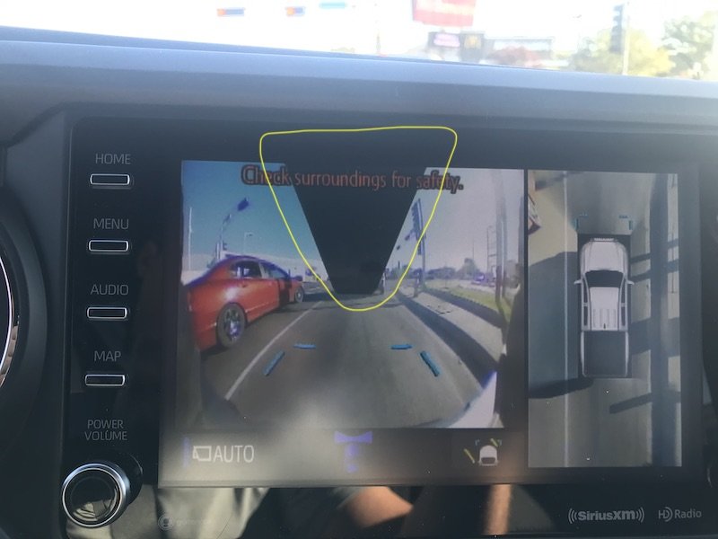

    Not sure if this has been addressed before, I STFA'd but maybe didn't have the correct terms.
    This is also on a new 2020 and appears during low speed movements (stopping/parking).
    Is it possible to remove the upper 'triangle' in the front camera view? It's clearly a software based mask, as there is no decal on the camera and you can see through it albeit poorly. Here is a picture of what I mean:

    I wonder what the purpose of that triangle is for? Doesnt look like it does anything but block the front view.

    I'm sure they do that so you can't use it to drive the truck. Just more nanny-features. :rolleyes:

    It maybe to block the front so you don't use it to drive your truck around.

    From a quick read of how the "bird's eye" view works, by 4 wide angle cameras stitching together a view. I think the triangle you're seeing is where the wide angle lens's view is lost or too distorted. It looks like your front view is not a single camera, pointed forward, but a camera on each corner, and combined as one view.
    This is my guess, and I'm gonna follow this thread to see what else is found.
    Edit: Re-read OP's post. Didn't realize you could slightly see thru the masked image.

    I'm not 100% sure of that. It looks like the car in front (another white pickup?) is ghosted under the triangle?

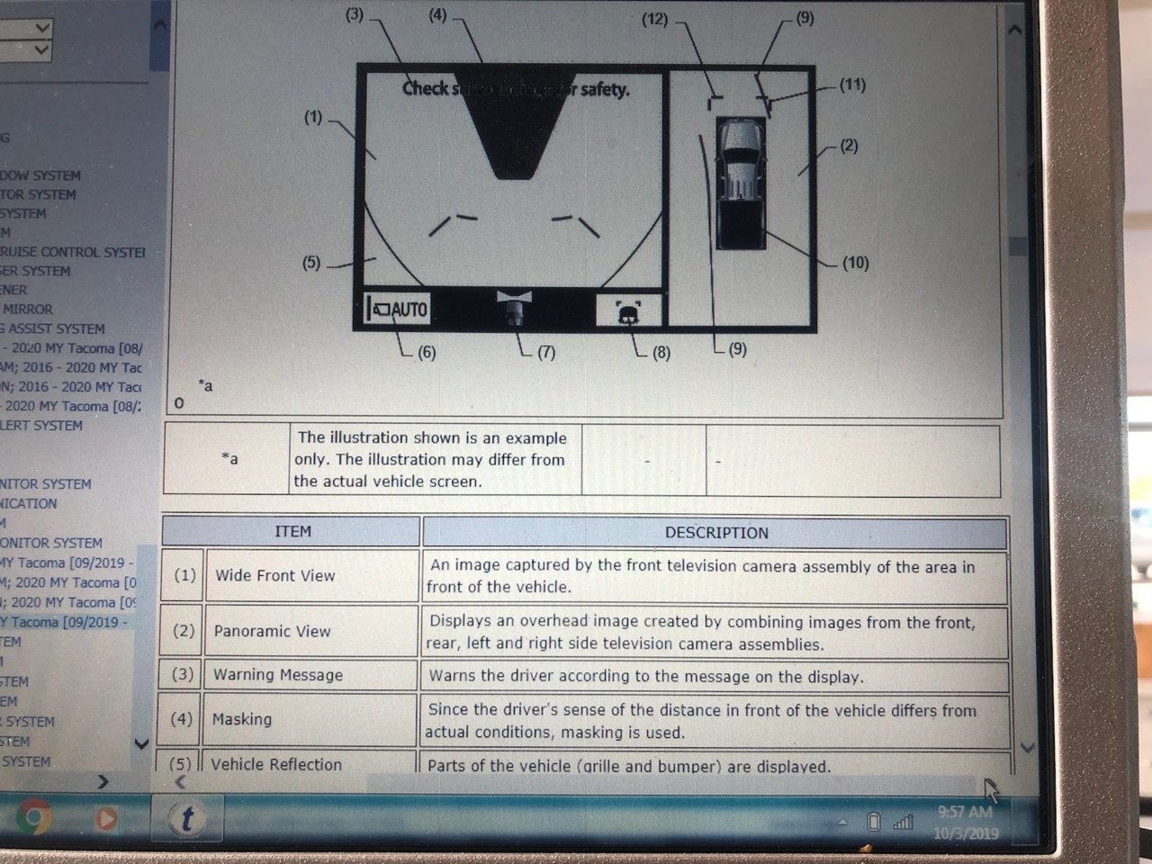

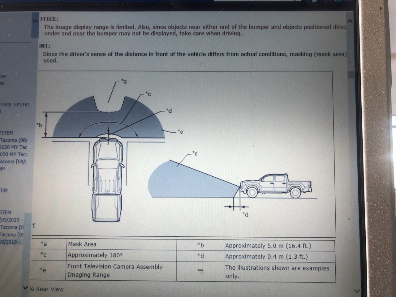

    I reached out to the sales rep... hoping there may be a setting or tweak I can make.
    There is a single front facing camera in the grill.
    The 'overhead' view on the far right is stitched together from the four inputs.
    As far as I can tell the front view is just the front camera.
    Yup, exactly right.
    tonered[QUOTED] likes this.

    I noticed this on a 2020 that I test drove recently so I'm sure it's how it is setup normally. I don't know why it is there but you can see through it as it is greyed over.

    It appears this is indeed an intended masking. I wonder how long until someone releases a 'patch.'

    So it's pretty much used so you don't use it to see vehicles further away since it's misleading. I can attest to that as I installed a front camera and vehicles seem much further away when looking through the camera. If you used it to drive, you would not be able to stop in time..
