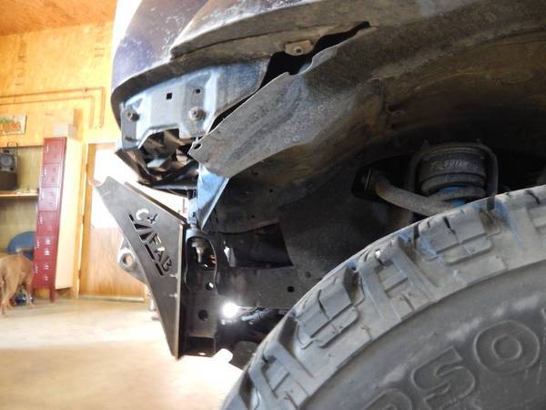

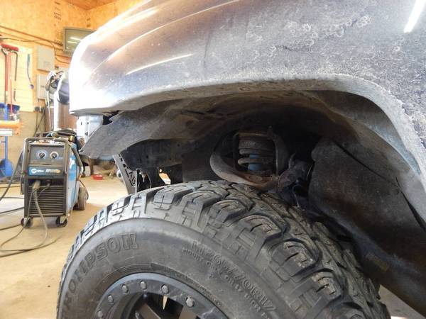

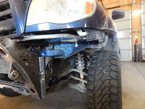

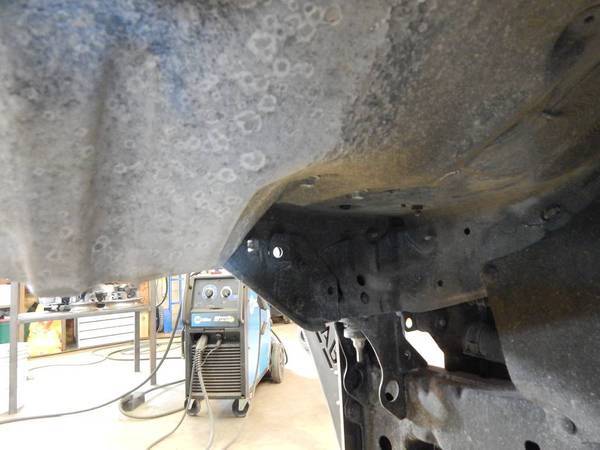

    here are some pics of mine. where I have it trimmed off, the edge of the plastic tucks up inside the lower lip of my plate bumper that I manufacture.
    Here you can just barely see the heads of the self drilling screws that go into the inner structure under the battery tray.

    Thanks for the pics Caleb. Ryan, do you have any pictures of how you modified the intake? Anything would be helpful. I'm trying to get as many ideas as possible before I dive into this headfirst
