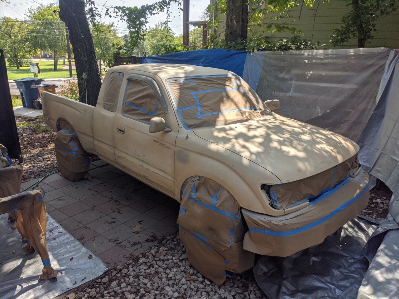

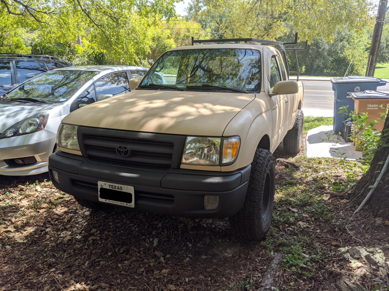

    Long time reader of TW but finally joined to show of the Labor Day weekend job I just completed. Happy to answer questions and give advice from my experience. Totally loving the final results here and hope yall do too!

    Neat but since you did the mirrors and vent visors, I would do the front and rear bumper and grille to match.

    Thanks for the suggestion. I'm thinking of going to go back to black actually on both. I still have the rack and bed to shoot black so would'nt be too hard (maybe next weekend)

    Looks great man. Is this something someone w/ no experience w/ a paint gun can try? I've wanted to do this to my truck for a while...not sure I will tackle it, but still considering it. How much were the supplies and equipment needed to complete the job? Thanks for offering advice. Pete.

    @pwgarcia I myself had little to no experience and found it to be as easy as countless videos via Youtube explain. You can get tons of advice on the process including how to shoot and get different textures. I easily watched 15 or so Youtube vids leading up to the job!
    My stats:
    9 liters of 12 purchased used to do the Black and Tan you see. I have 3 more bottles to do the truck bed next. ~$400 at Amazon which comes with the gun and hardener
    I got the Tintable option to be able to customize the tan. Go to your nearest car paint supply store (Tasco here in Austin, TX) to get the tint. It saved me about 50% costs vs ordering the 3-ounce tint bottles anywhere online. ~$100
    Prep materials of tape, paper, and plastic. Gloves, ventilator (mask), borrowed a friend's 15gal Dewalt compressor, sanding supplies, acetone and rags for cleaning, tarps for overspray prob a few more things. ~$150
    To be safe I would say you should plan for an $800 job. Or about 2 car payments if you were to buy a new truck ;)
    I'd also pick a time you have a 3-day weekend. Could be done in 2 days easy if you prep leading up to it. I bondo'd multiple dents and some holes out of her which added a half day to the job. You could never tell now I backed into a few things!

    That looks great. Really does ... I like the black bumpers , good color combo, enjoy the ride.

    Looks really good!!!!
    I did mine too with monstaliner and it came out way better than I was expecting.

    Looks fantastic! I’m debating this color, red or blue. I wanted to do it over the summer but raptor liner claims they are out of the sample sheet still ughhh. Were you able to get one?
    How many layers did your spray? How rough is the texture?
    Realistically I’ll probably bed line mine too since my clear is falling apart and I don’t like the green
    How is it holding up? I’m between the 2 brands

    I'm over two years in, and I can't see any difference from day one. One of the best decisions ever!!
