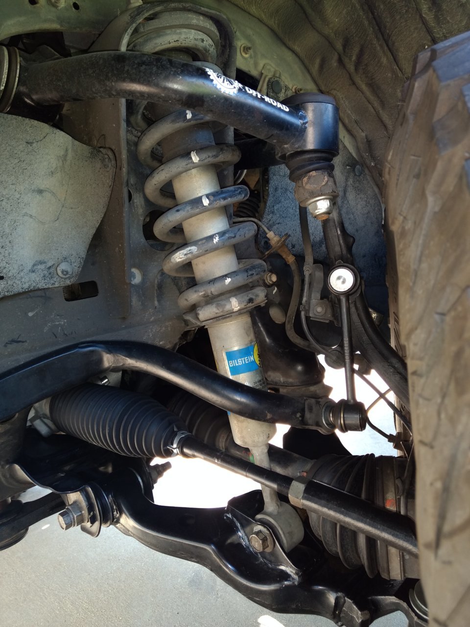

    Before taking off the sway bar and rubberizing the wheel well but you get the picture. Got better alignment specs, and the ride is much better. Much better clearance than stock UCAs too. 4CA36573-986D-418E-B599-94A3EC7ECFA1.jpg
