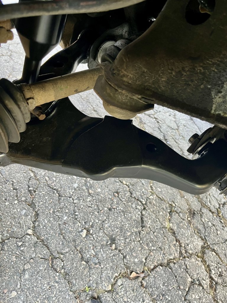

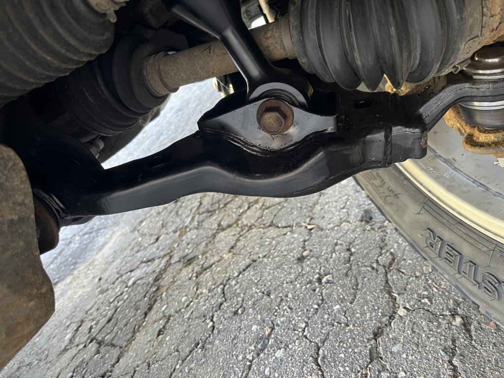

    Posted asking about these LCA’s in another forum and there was no response. I was on the fence and just went with it. I was told Hard Race is the supplier for bushings and ball joints.
    Delivery took just over 3 business days to get to my place in Canada. I didn’t have to pay brokerage or additional taxes, so was surprised. May still get dinged.
    Even with the crap Canadian dollar, these were $300.00 cheaper than OEM after taxes and shipping. Not much more than the Beck & Arnley I priced out on Rock Auto.
    Will see if it was worth it to go with them or not. 4 Cam bolts came standard. Seem beefy and decently made.
