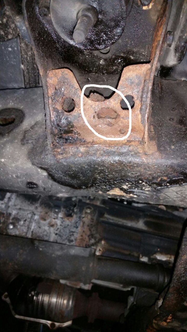

    My '04 Tacoma is Still within (barely) and eligible for the 15 year DOS extended frame perforation warranty so I decided to take a good look at the frame one last time and found this: The front left cab support has a greater than 10mm perforation as circled in the photo.
    Is this enough for Toyota to replace the frame? The truck goes in next week for state inspection (PA) and I'll bring this up to the service writer.

    I am not sure if the cab mount is considered part of the frame.
    I bet with some serious looking I could find enough

    Well, it's welded on and cannot be purchased separately. Looking at the frame in the parts catalog it clearly shows the mount as part of the frame. The rest of the frame seems solid.
    The coating Toyota applied blocked the drain holes where the mount is attached to the frame.
    I have all the paperwork and will see next week what the dealer has to say about it.
    PA state inspection clearly states that the frame must be solid to pass.

    Go over the entire frame with a hammer, you should be able to find more, the mount failure might be enough but I would find more to strengthen your case. Good luck!

    After they found the hole in the cab mount. I spent two hours under there peeling off the coating where it was rusted underneath. I ended up with 1/2 a 5 gallon bucket of rust flakes and undercoating but surprisingly the rest of the frame appeared solid.

    Took my truck to the dealer today and a new frame is on order! 4 weeks before the extended warranty expires. Probably one of the last ones done under the 1st Gen extended campaign.
