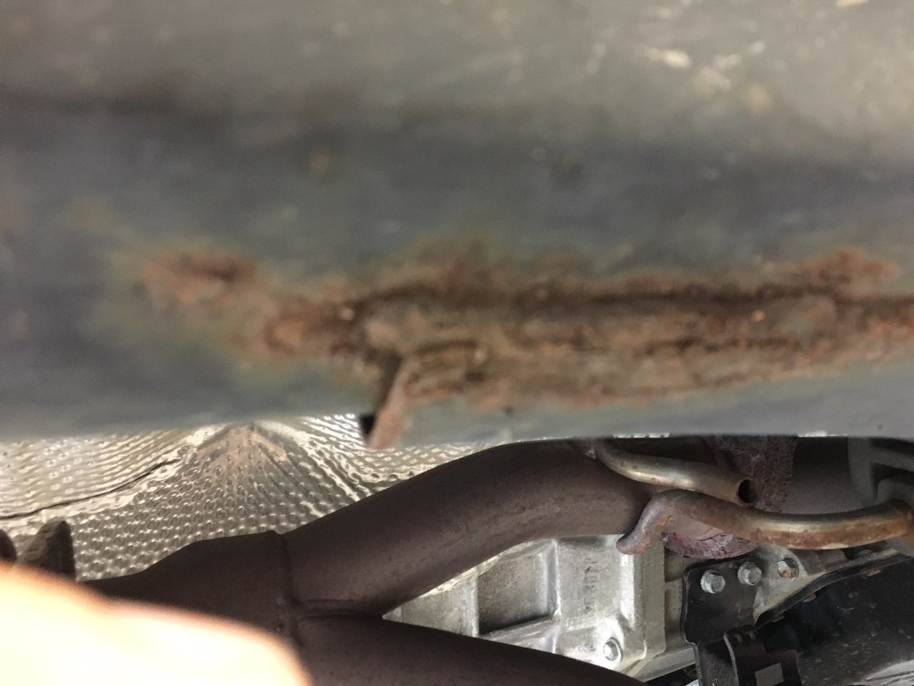

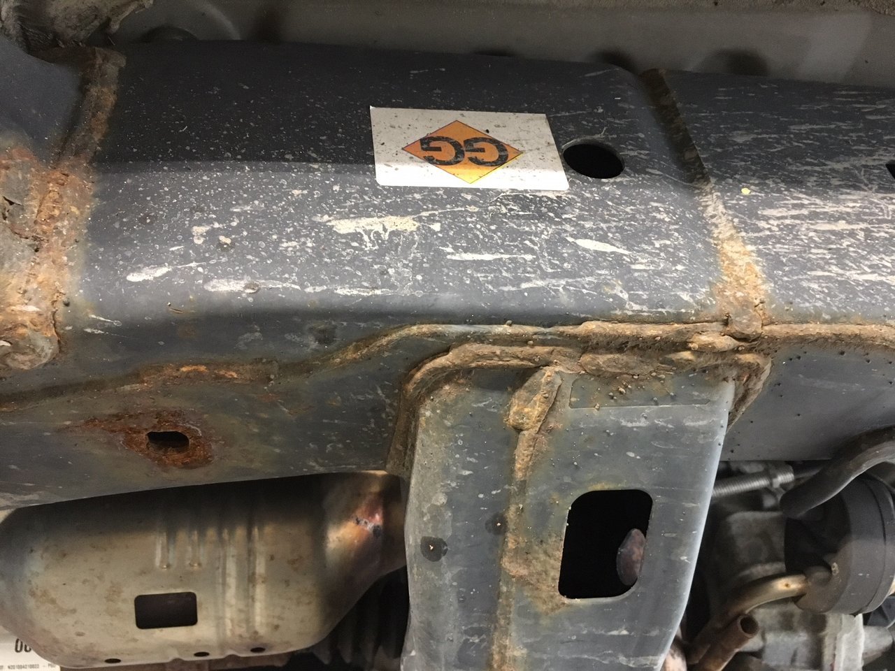

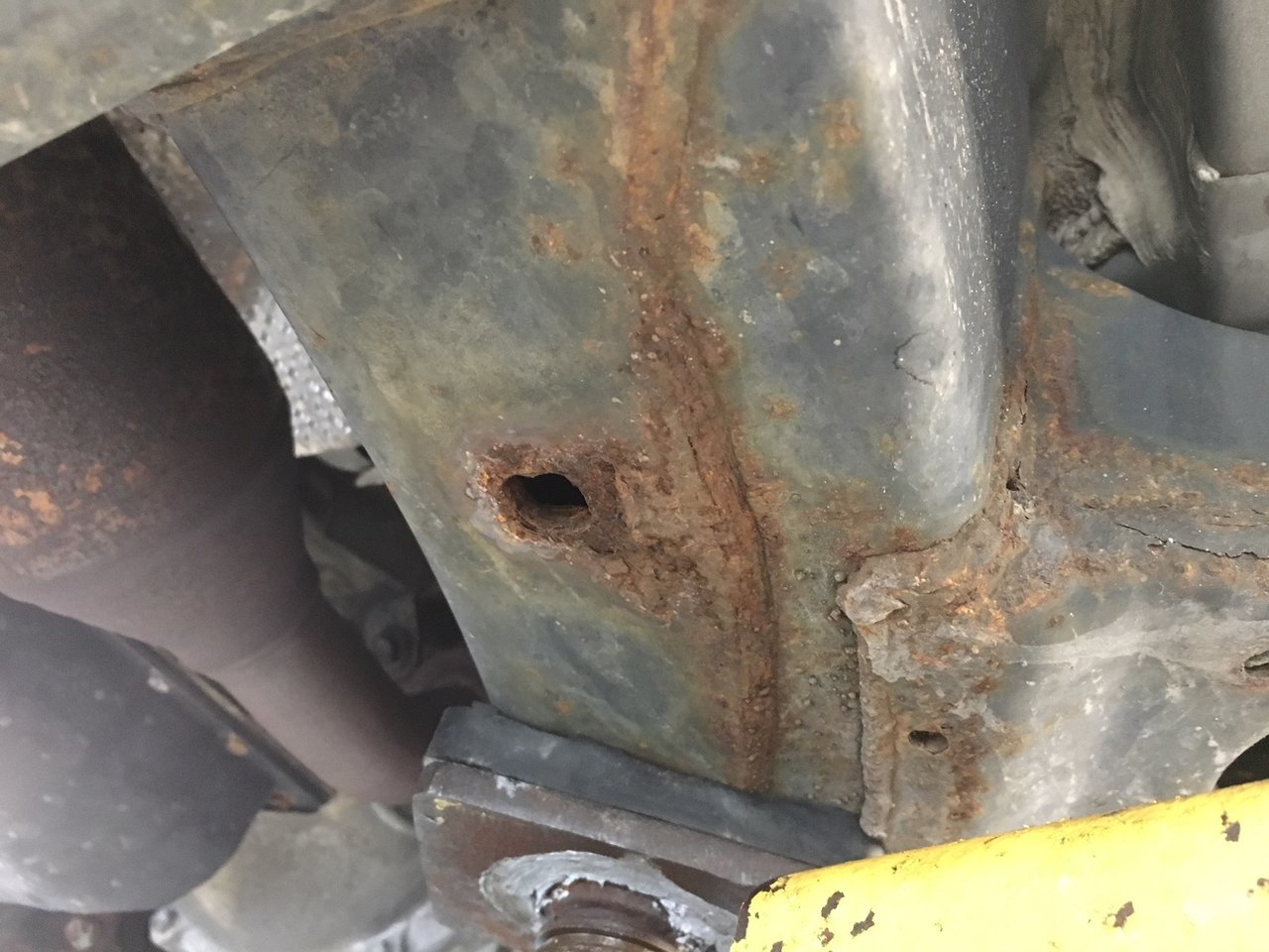

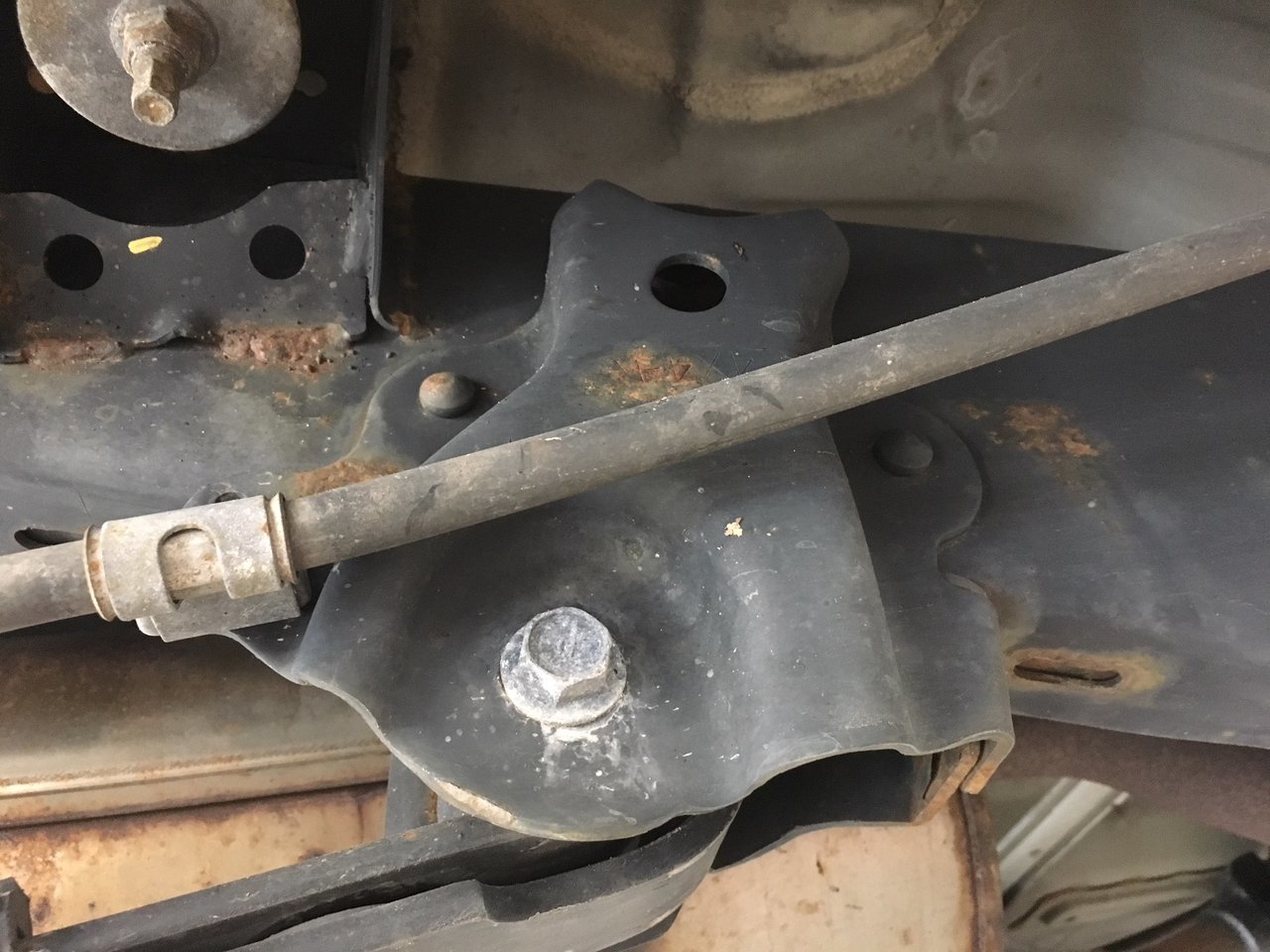

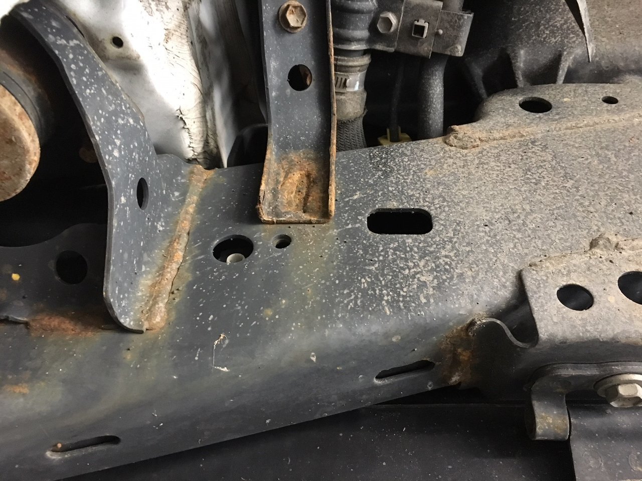

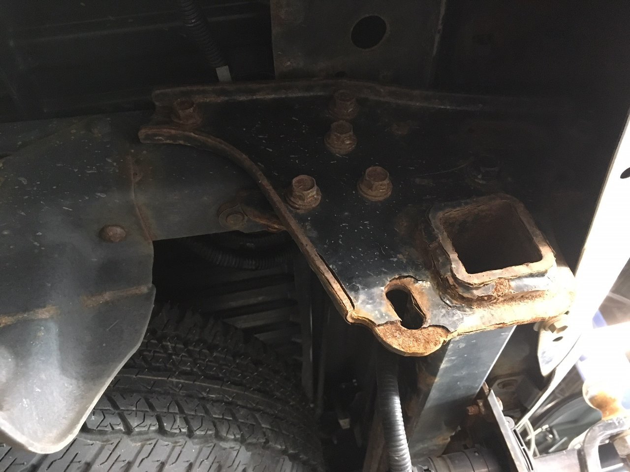

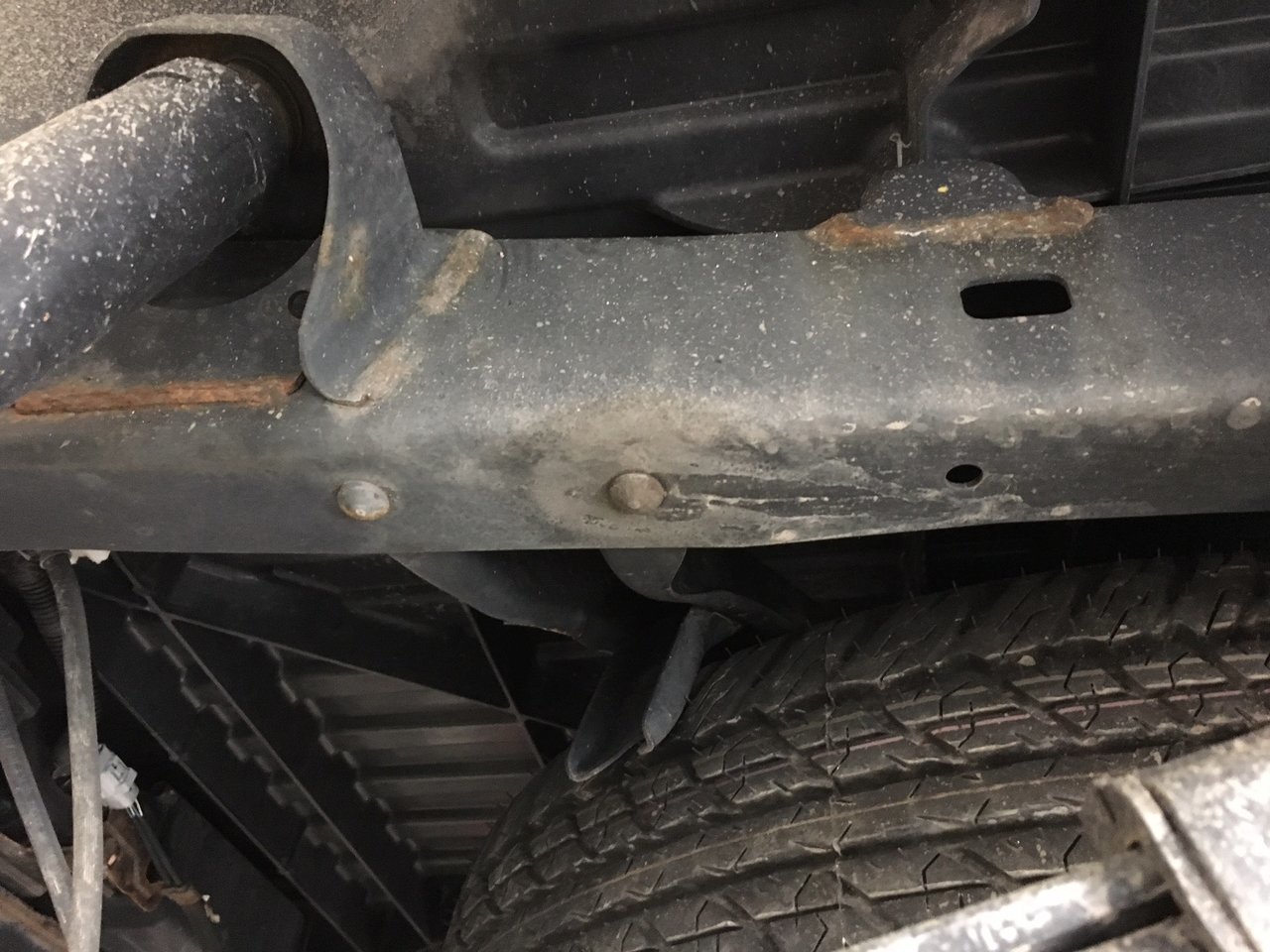

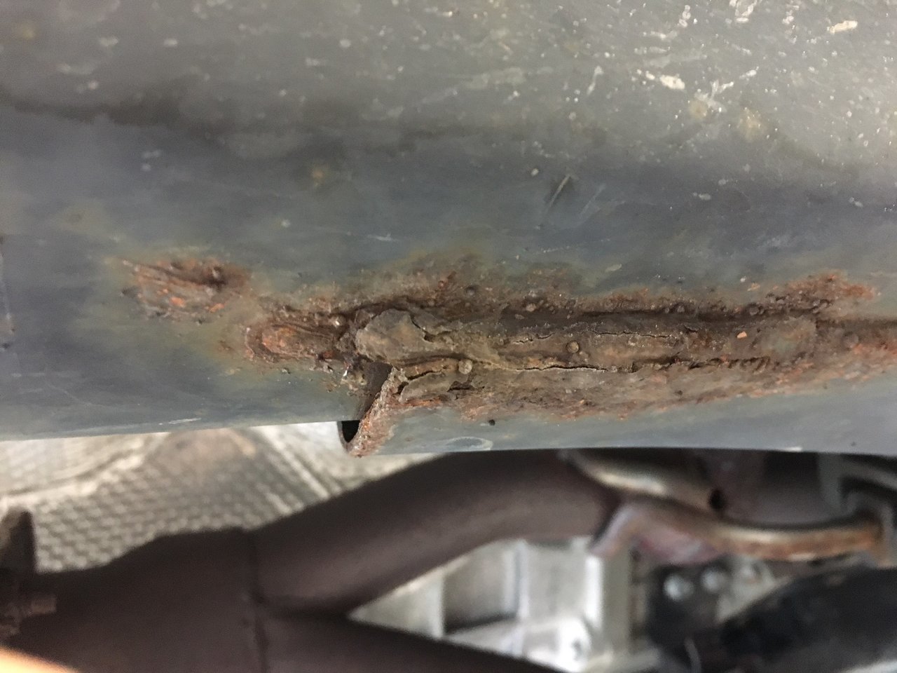

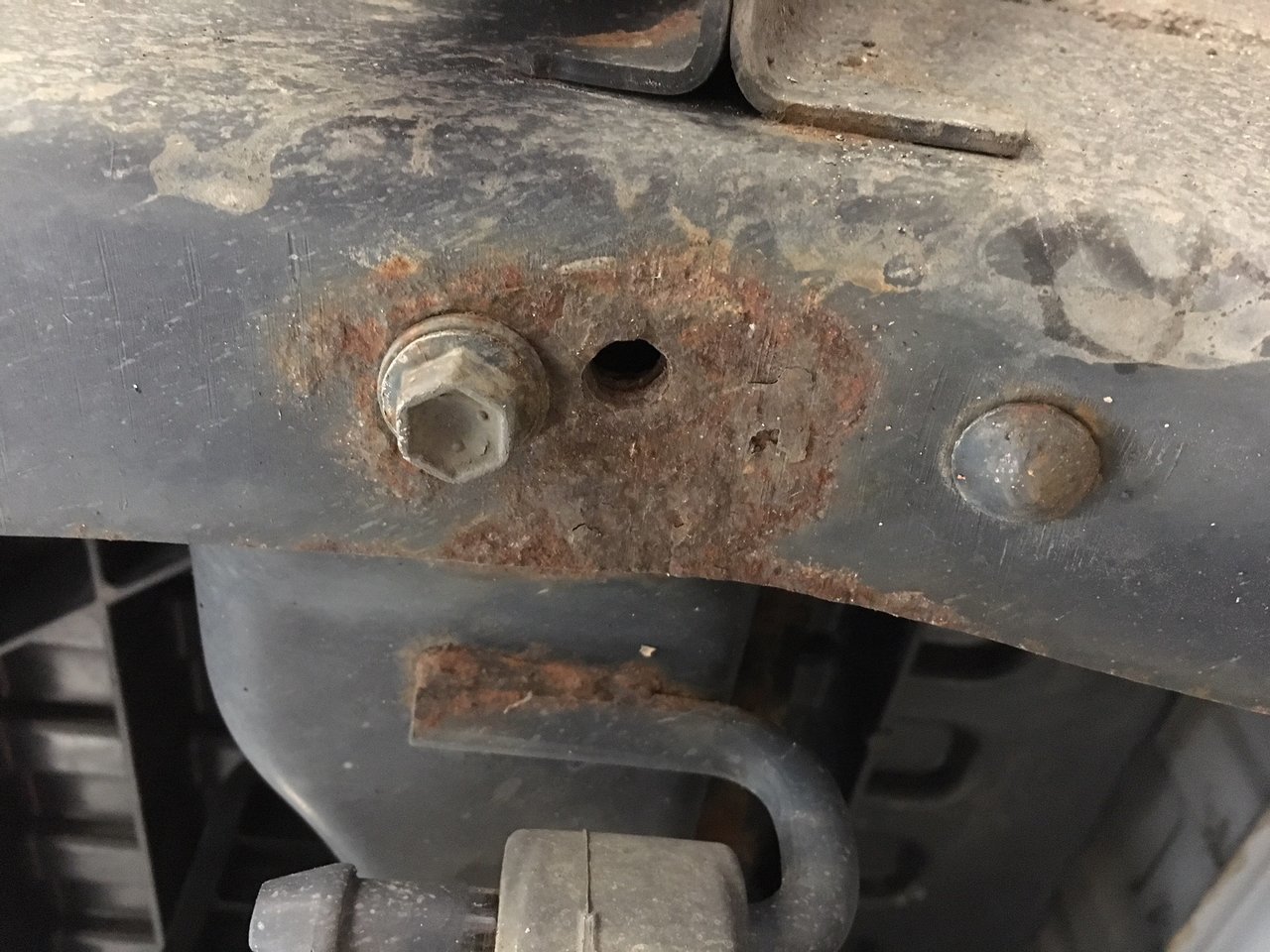

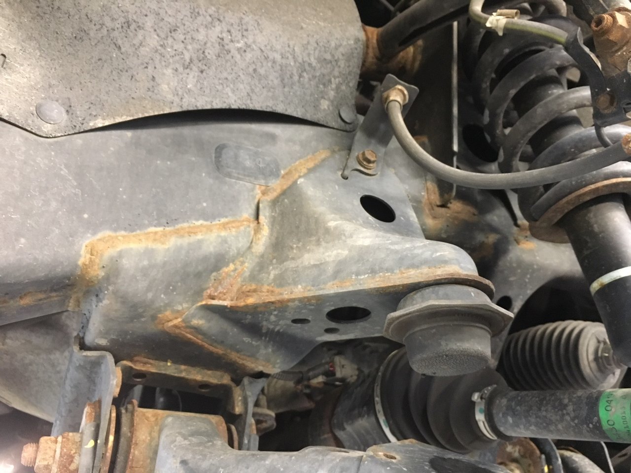

    Pics of my frame rust (2010 Tacoma in Maryland)
    dwalbert Tacoma Frame Rust (4)-10-25-2017.jpg dwalbert Tacoma Frame Rust (5)-10-25-2017.jpg dwalbert Tacoma Frame Rust (6)-10-25-2017.jpg dwalbert Tacoma Frame Rust (7)-10-25-2017.jpg dwalbert Tacoma Frame Rust (8)-10-25-2017.jpg dwalbert Tacoma Frame Rust (9)-10-25-2017.jpg dwalbert Tacoma Frame Rust (10)-10-25-2017.jpg dwalbert Tacoma Frame Rust (11)-10-25-2017.jpg dwalbert Tacoma Frame Rust (12)-10-25-2017.jpg dwalbert Tacoma Frame Rust (13)-10-25-2017.jpg dwalbert Tacoma Frame Rust (14)-10-25-2017.jpg
    dwalbert Tacoma Frame Rust (1)-10-25-2017.jpg dwalbert Tacoma Frame Rust (1)-10-25-2017.jpg dwalbert Tacoma Frame Rust (2)-10-25-2017.jpg

    That doesn't look to be in "really good shape"
    I lost a Tundra to this plague! And unless they changed the CRC recipe all it seemed to do was hide the problem and stop surface rust. Unless they remove 100% of the existing rust.
    The issue isn't surface rust but rust within the "layers" of steel, It looks like your is already starting to delaminate.
    I would not CRC but bring it in every year for inspection. Unless not CRCing will void you of replacement in the future

    Your frame looks bad. Dealer probably didn’t want to replace it on their dime. I would have pushed to get it replaced.
    As far as your brakes, just do everything yourself for about $200. It’s pretty easy.

    By Toyota standards that is not a bad frame. Mine has more surface corrosion than yours but they won't replace it until I have a 10mm hole in the frame. (One corner is certainly making its way there) While I agree it shouldn't be considered "ok"- Toyota certainly will not replace it yet as it is still structurally sound, even though it won't last forever. It just sucks.

    Toyota has specific requirements for inspecting the frame. It's not a go/no-go judgement on visual. Not that the test is much better. They look for perforations and hit specified spots with a hammer to determine a fail. To my eyes yours does look rusty but not as bad as some photos I've seen.
    I would not do a CRC coating if they give you the option not to and stay under warranty. The only way to fix rust is to cut it out, grind it off, treat with passivation, prime and paint. Even this is only slowing it down. Rust never sleeps. The coating may have been good when they built the frame but after rust starts all it does is give it cover and lets it churn underneath.
