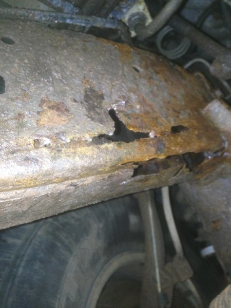

    Here's what absolutely no rust proofing does after 12 winters in the north east of Canada. Of course this is a Tacoma frame, so a little more severe than most vehicles. Once my local welder friend started beating around to find solid metal it was about 5 times worse. A lot of steel and welding to fix this one.

    I'm surprised that he was able to even salvage that one.

    Nothing money can't fix. I sent it on its way shortly after as I think it was a never ending battle.

    george3 was there an actual hole in the frame or just rusted bad where the frame is pressed together?
