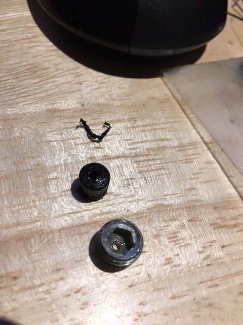

    OK. 24 hours later.. no recommendations. No exploded views anywhere on the web. No YouTube's which had a plug instead of a Schrader valve..nada. Wait and call the off-road shop tomorrow? Nope. I was pretty sure there would be a valve under the plug. I drilled out the anti-tamper portion of the plug and cracked the plug halfway. I sprayed with soapy water checking for bubbles. Huh..no bubbles...must be a valve under the plug right? Nope..the plug is PART of the valve. I did not drill the hole in the plug..it was there but filled with nylon from the safety plug I drilled out. This shock fills with a needle just like a football. I will be installing typical Schrader valves as part of this rebuild. I will disassemble tomorrow and decide which shims to run. IMG_1750.jpg

    Fox make a specific needle for shock filling, this is it closed and open. Its connected to a regulator and nitrogen bottle. It is not a standard football style needle, I know this style is used by a few shock manufacturers.

    The guy that posted the correct Fox tool is 100% correct. You do not use a ball needle. The needle is small gage similar to a medical needle.
    The nylon pellet starts life as a ball and is set into the drilled set screw to act as a tamper resistant device.
    Using the rubber disc, the small needle passes through. The nitrogen is put into the shock. Then the setscrew is tightened to prevent loss of the nitrogen. If the setscrew has not been loosened slightly prior to inserting the needle, often the needle breaks. If the set screw is not tightened after gassing the shock, the gas will leak out.
    Fox uses the same setup on bicycle shock. I do convert those to Shrader since those shocks often require 500 psi.
    Your best bet might be to order new rubber discs, order the tool and retain the original setup. I say this not knowing if my shrader method would work or if the shrader would be vulnerable when the shock is installed. Honestly though, it is a pretty poorly designed setup.
