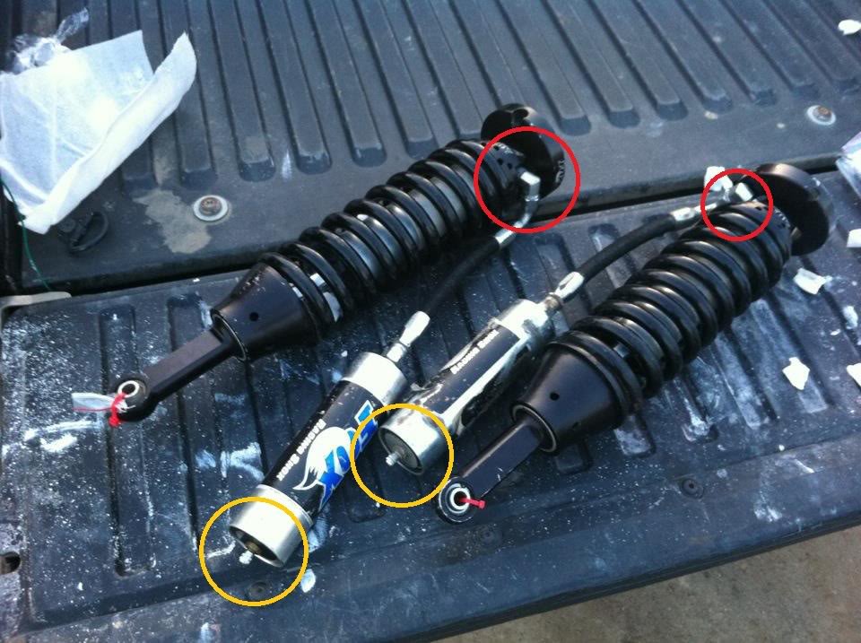

    Well I can't seem to find a how to on this and have a couple of questions so if anybody has some info please chime in!:D
    I need to replace the current coils on some Fox 2.5's I bought used. I put them on and the coil rate was waaay to high. So stiff that they added another 1.5" of lift on top of the 2.75" I already had with my OME 885 coils.
    I've done coil replacement and adjusting on my 5100's but I'm wondering how to do these.
    I was thinking
    1st) Let the nitrogen out of the resi's
    2nd) Remove resi hose
    3rd) Remove adjustment collars
    534521_416040208412589_100000198399299_1_c7699af338517a44d7f78b7671de77f49e575a8c.jpg
    Is that all there is to it? Besides trying not to lose any oil and having to recharge them to specified psi?
    Thanks for the help guys.
    edit: Yes I will have to remove the top plates first.
