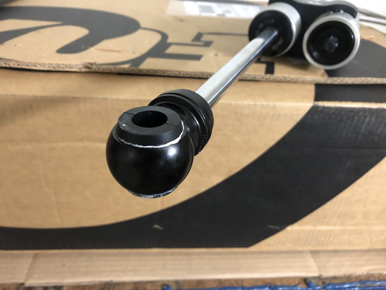

    I was not able to find a good how-to for replacing the eyelet bushings on the Fox 2.0 rear shocks, so here is one. I had to kind of figure this out as I went, so that’s what I’ll show with the pictures, but anyone with a different or better technique should chime in so we can make a decent guide.
    Fox 2.0 Rear Shocks with Reservoirs and compression adjust
    985-26-117
    These shocks come with eyelet bushings that are too long, and designed for a different vehicle, FJs I believe.
    The first step is to pull those long bushings out. Fortunately, they are too long and not too short, so you can grab them with some long pliers or channel locks and just pull. I grabbed the edge with a good chunk of rubber and pulled down while twisting my arm down to yank them out. The process took about 6 seconds once I figured out the technique.
    Next comes putting the new bushing in. There are a lot of people that complain this this is super difficult and nearly impossible to get in, and I saw videos online of people trying to make presses to get the bushing started using bolts, washers, and hose clamps. Don’t worry about any of that. First, cover the outside edge of the bushing with a generous amount of multipurpose grease and place it position.
    I used a wood 2x2 I had sitting in the garage to use as a firm backing that wouldn’t damage the metal around the eyelet (workbench is covered in cardboard due to painting project, unrelated). Next, I dug around my tool box to find a flat object. You could use another piece of wood, metal... just something hard and flat. I used a metal piece from the back of my drawer.
    I don’t have a picture because I only have so many hands, but I centered the metal over the bushing, and used a 6 pound hammer to pound the bushing down. Make sure the flat object is flat over the bushing and you hit it close to square. It took me one hit to get in, so it was very simple.
    I wiped the excess grease off and use a light rubber mallet to hit the bushing one extra mm to center it in the eyelet. Now repeat for the other shock and you’re done.
    Total time: 15 minutes (mainly just getting tools)
    Difficulty: 0.5/5
    You can definitely do this yourself. Feel free to ask questions and if you have any different techniques, add them below. I will try to keep the main post updated as time progresses.
