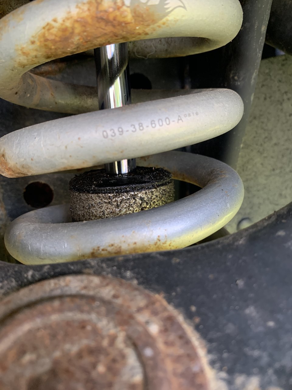

    I was in changing my front pads and rotors today and notice my passenger side Fox 2.0 coilover had been leaking.
    Who have people used in the past to rebuild these? I’d prefer to ship the whole coilover, from what i’ve heard a spring compressor doesnt fit these coils because they’re too close together. The coils themselves rusted from the inside out, Fox actually sent me replacements for free so i’ll have those put on at the same time.
    I’d rebuild them myself but it looks like you need to fill them with gas.

  11. Sep 30, 2020 at 8:38 AM
    Larueminati
    Larueminati [OP] Well-Known Member
    Dec 6, 2013
    #118009
    516
    Western MA.
    2013 DCSB TRD 0FF-ROAD
    This may be a stupid question but how worried do I need to be about a slight bit of oil coming out as pictured? Typically i'm not a procrastinator and I always to PM but this time around I may have to run it for two weeks on a trip before I can park the rig for 4 weeks. I'm not well versed on suspension internals.
  12. Sep 30, 2020 at 8:45 AM
    AccuTune Offroad
    AccuTune Offroad Well-Known Member Vendor
    Jan 28, 2019
    #281012
    1,640
    El Cajon, CA
    In short, its not good :)
    You loose oil, loose Nitrogen, loose pressure and lubricant, heat will start forming and then things will get worse and worse to the point the shock cannot be rebuilt very easily. Hard to say how much oil you lost, and its not very easy to add nitrogen to the these IFP coilovers...
