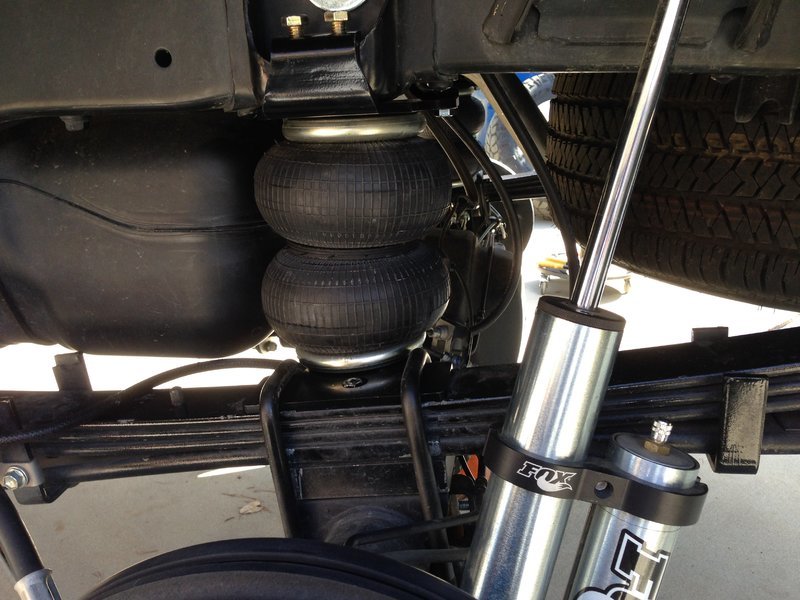

    Rear, 1" block, air bags, inverted resi shock.
