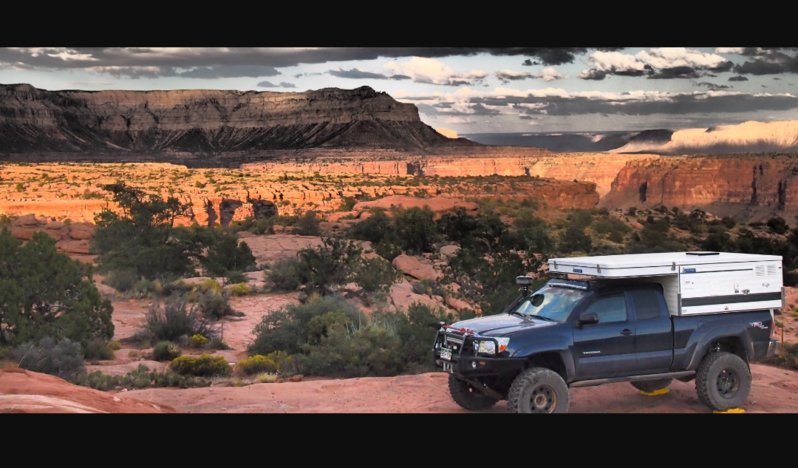

    Do the 4 cylinder reg cab 4x4 5 speed got enough power to haul a FWC? I been looking at these campers for years and seems like they're only on 6 cyl.

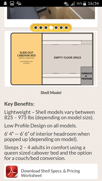

    It's not that heavy. it says it's 900lbs dry weight.

    Do it !!! Just regear. My truck weighs in at 5400lbs with the rtt and awning on before I add the rest of my gear. Still get 20 mpg highway :turtleride:
