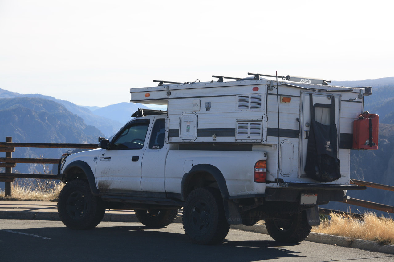

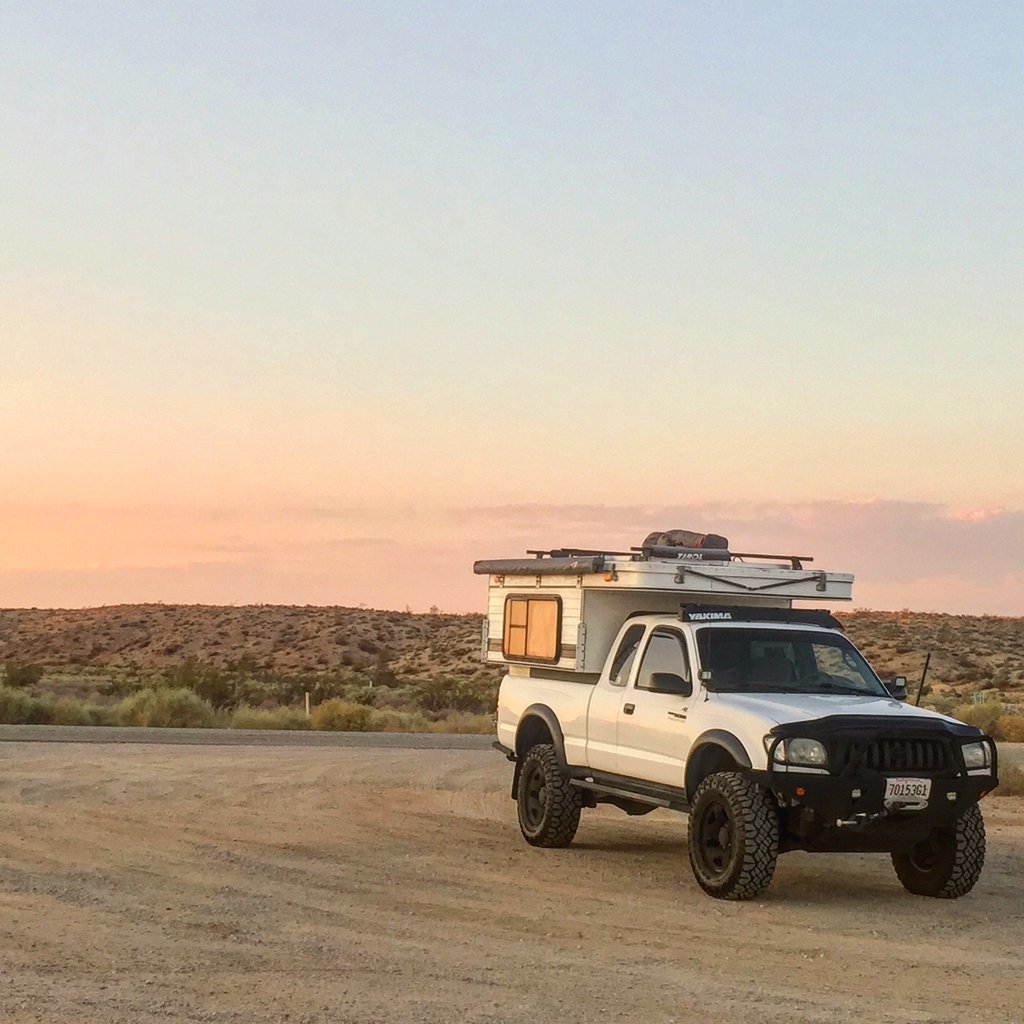

    Welcome! You're going to love your setup.
    We run OME Nitrocharger Sports, 883 coils, with Dakar AALs with an extra leaf added, in addition to the firestone ride rites + daystars. Also took off the sway bar for articulation off road, just drive it accordingly on the road.
    I'd recommend also load range E tires.
    Similar to you, I had no previous wrenching experience, and this is our first rig. Just research & take your time, you'll learn everything you need to know here and a few other sites already mentioned.
    Cheers & good luck on your build! Holler if you have any specific questions on our setup. Excited to see your brand new setup!

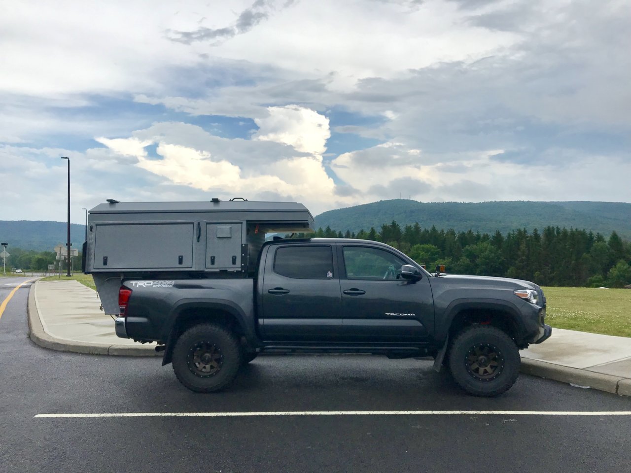

    Not a 4Wh Camper but my Alu-Cab weighs in at 1100lbs.
    I am running OME +660lb springs and 886X front coils. JBA Upper Control Arms and a set of Firestone Ride Rites w/ Daystar Cradles to supplement the rear end. You could have springs built to hold the entire weight... but you won’t love it when you take the camper off.
    I am 100% satisfied with my setup it’s been all the way across the country and back from Coast to Coast.
    In addition to suspension you will absolutely want to re-gear. 4.88’s or 5.29’s. Depending on your chosen tire size.
    FWIW I looked very hard at 4Wh Campers before deciding the Khaya was a better choice for me. They are pretty darn nice though!
