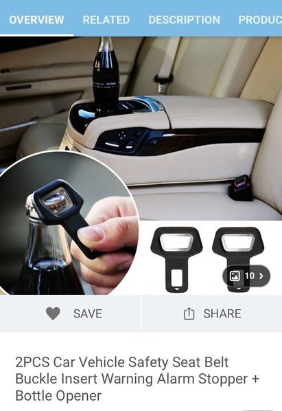

    Now you can open a cold one while not wearing your seatbelt!

    Why not just do the disable process?

    clearly someone missed a joke.

    It's way easier to do that !

    I just cut some blanks from a 5 gallon bucket lid. I like my truck to tell my friends to wear their seatbelt.

    Drinking and driving made easy !
