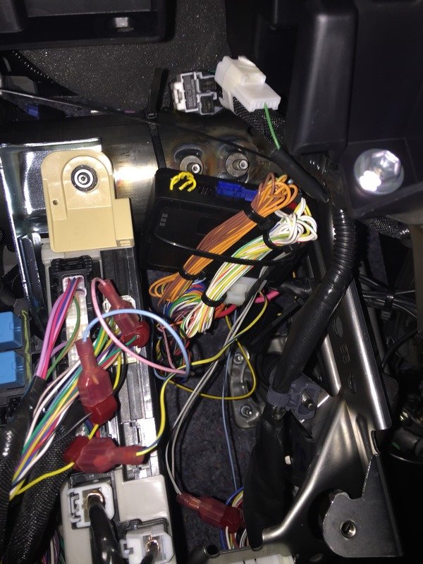

    So I ordered the Fortin Evo One because of the 3x remote start via oem remote. Here is a Mini write up/install guide.
    In the Box ...
    Connections at Ignition Switch
    Feed wires down steering column and locate them in the spare space beside the bcm, tape/ziptie well.

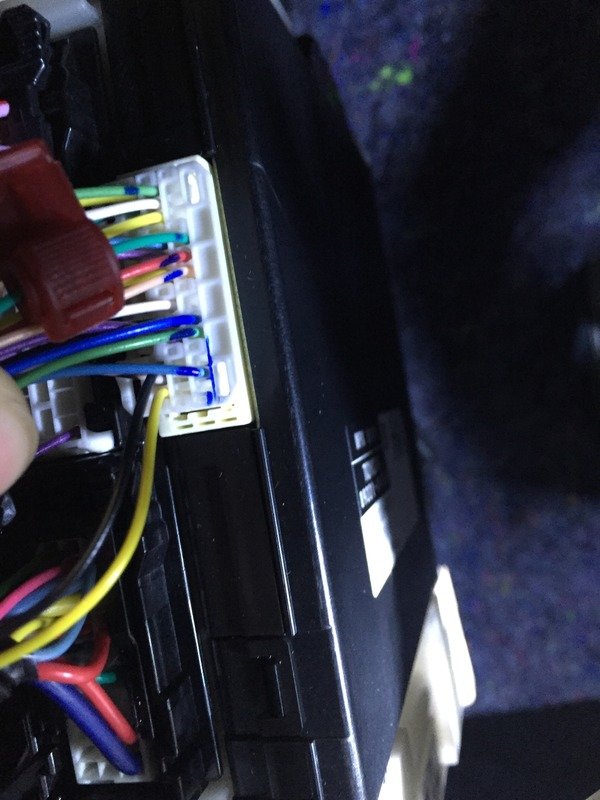

    Locate Light Green Wire at BCM (top right of connector) for Parking Lights
    Locate the Yellow wire for the driver door pin at the bottom left of the connector and the black wire for door lock data 2 wires up from the yellow. (See below in reference to black door lock data)
    In this bundle there will also be Door Lock/Unlock wires Light blue and Green. (Not pictured, See below)

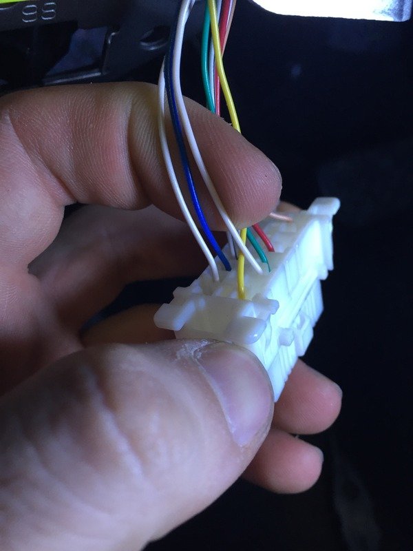

    Locate the OBD-2 Connector and unclip it so it is easily accessible. You need 3 wires from this connector, the Blue and White side by side (Blue=Can High White=Immobilizer) and the white wire on the top (White=Can Low)
    Wrap up everything nice and tuck in in the open spot next to the BCM.
    Installation guide including pin-outs and wire colors i may have missed.

    Not every step is in this thread, i put this up because everyone has questions about the 3x lock start. It is not difficult to do if you know your way around this kind of thing. Kinda like here is where the wires needed are, between this and the instructions nobody with a decent amount of common sense should have a problem.
    If you use scotch-lok connectors make SURE you buy the correct pliers to crimp them, do not use needle nose. They will pull out, cause you massive amounts of grief and possibly short something out.
