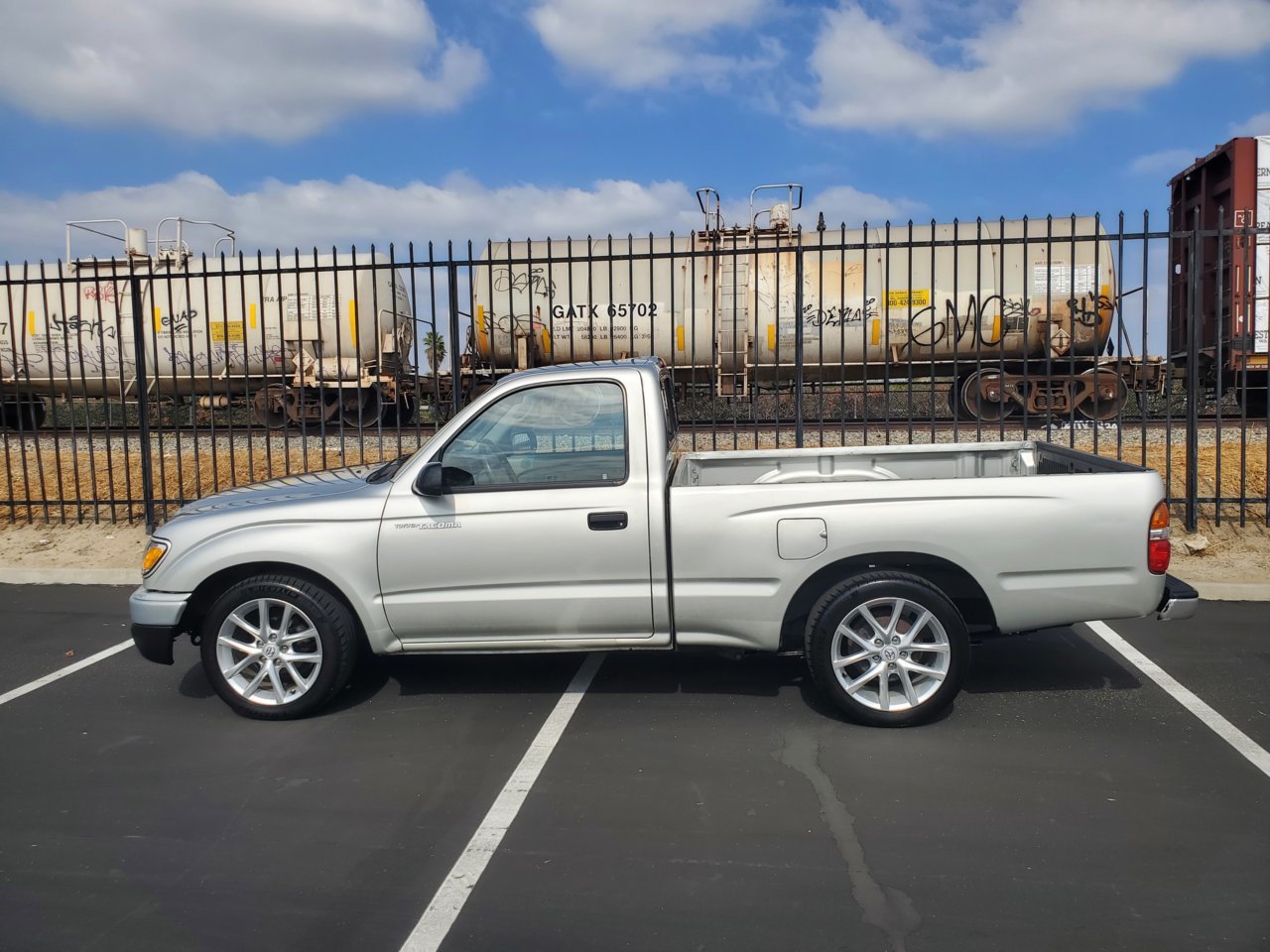

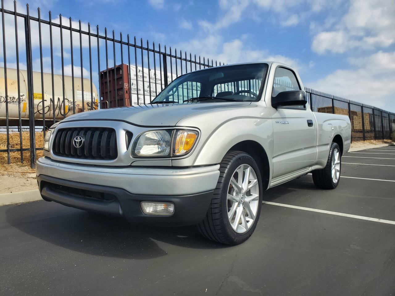

    I am running 17x8 with 45mm offset wheels and 245/45/17 tires. No issues even with almost 3" drop all around.
    If you run 30mm offset with 8" wide this will make the wheels stick out 15mm towards the outer fender. Could be tight for you, without a drop you may not have any issues, or you may need to roll your fenders. I would "think" youd be ok but results seems to vary a bit on these old trucks...

    Glad you upgraded your rig without any issues! Thanks for the compliment on my truck too. Mine is dropped a bit but not so much so I can still use it as every bit of the truck it once was but it actually rides nicer and handles better now too when its not loaded. It was a bit bouncy and harsh previously with no load in the bed.
    The caveat on mine is the load range on the tires is not enough for the full tow capacity but I did not buy a 4 cylinder pickup for maximum towing duties of course. I also opted for tires for pure dry weather performance though, not work. The suspension and ride height however I would say is not an issue at all and I have loaded the bed up pretty good with loads of rocks recently that did drop the rear maybe an inch or so and did not have issue.
    I had local legendary leaf shop Deaver Spring build me custom coils to my specifications: 2.65" drop in front with 25% rate above factory (368 lb).
    The rear actually still has the stock leafs but were de-arched by Deaver to give roughly a 2.75" drop.
    This was not the cheapest way to drop the truck, but it rides better than factory now and handles like a Ferrari (from decades ago) in the curves! yet still has enough "truck-ability" to meet my needs.

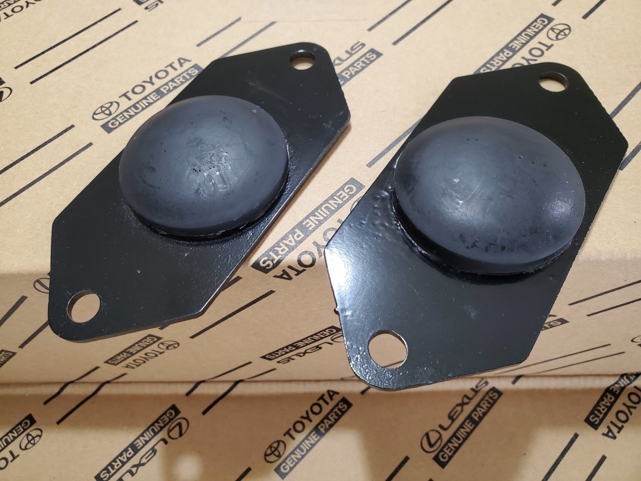

    This pic shows the ride height in the rear. See I left a bit of rake just so I could load this thing up a bit without the frame hitting bump stops.
    Of course you need to add low profile bump stops to get that suspension clearance back. I made these:
