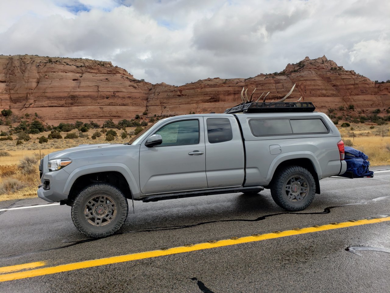

    I went with Bilstein 6112/5160s and Wheelers 3 leaf AALs. Left the overload in, have sliders and ARE topper w/Ascend basket. Ride is smooth and truck handles well.
    This is the truck with a light load:
    And with a heavy load:

    Nice. Looks great, I like your setup, that's exactly what I'm planning on getting. What clip settings are the front Bilsteins set at?

    Looks like you got a nice bull - good luck this season :cheers:

    Thanks, it was a nice bull! And great eating too!
