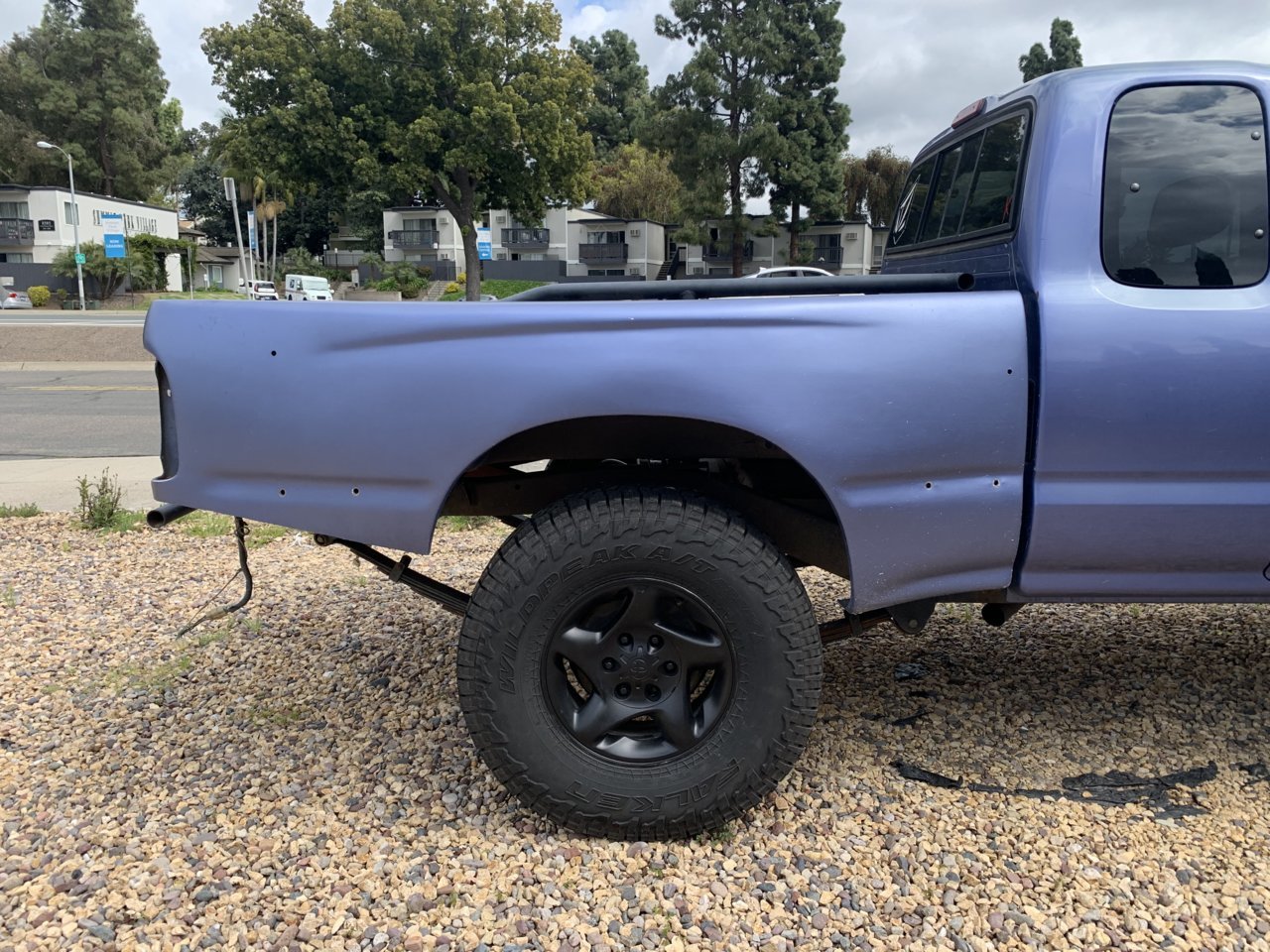

    These are about 95% of the reasons Im going back to MT currently.. I DD the truck and have other desert toys now so back to normal it is

    SOA MT? What about E30's and staying SUA?

    staying SUA is possible

    Deaver makes E30 and E30 HD which gives a ton of lift. I'm running the E30's and made me sit a little stink bug but I haven't run them (or even have my truck with a rear at all lately). It sat almost even with like a 2" lift with 2 35's in the bed if I remember correctly. Definitely a more load bearing spring than the F67's. @Anthony250 runs the E30 HD pack but he's on lift spindles with two spares.

    yeah the truck sits perfectly level but any weight and it sags. so E30s might be the way to go.
