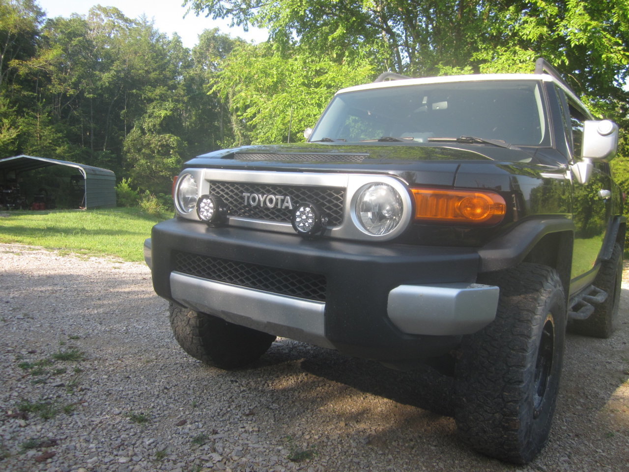

    Well, solved the fog/driving light issue. 2 9 LED Westin lights, wired to either function along with the High Beams, or by themselves.

    Looks good
