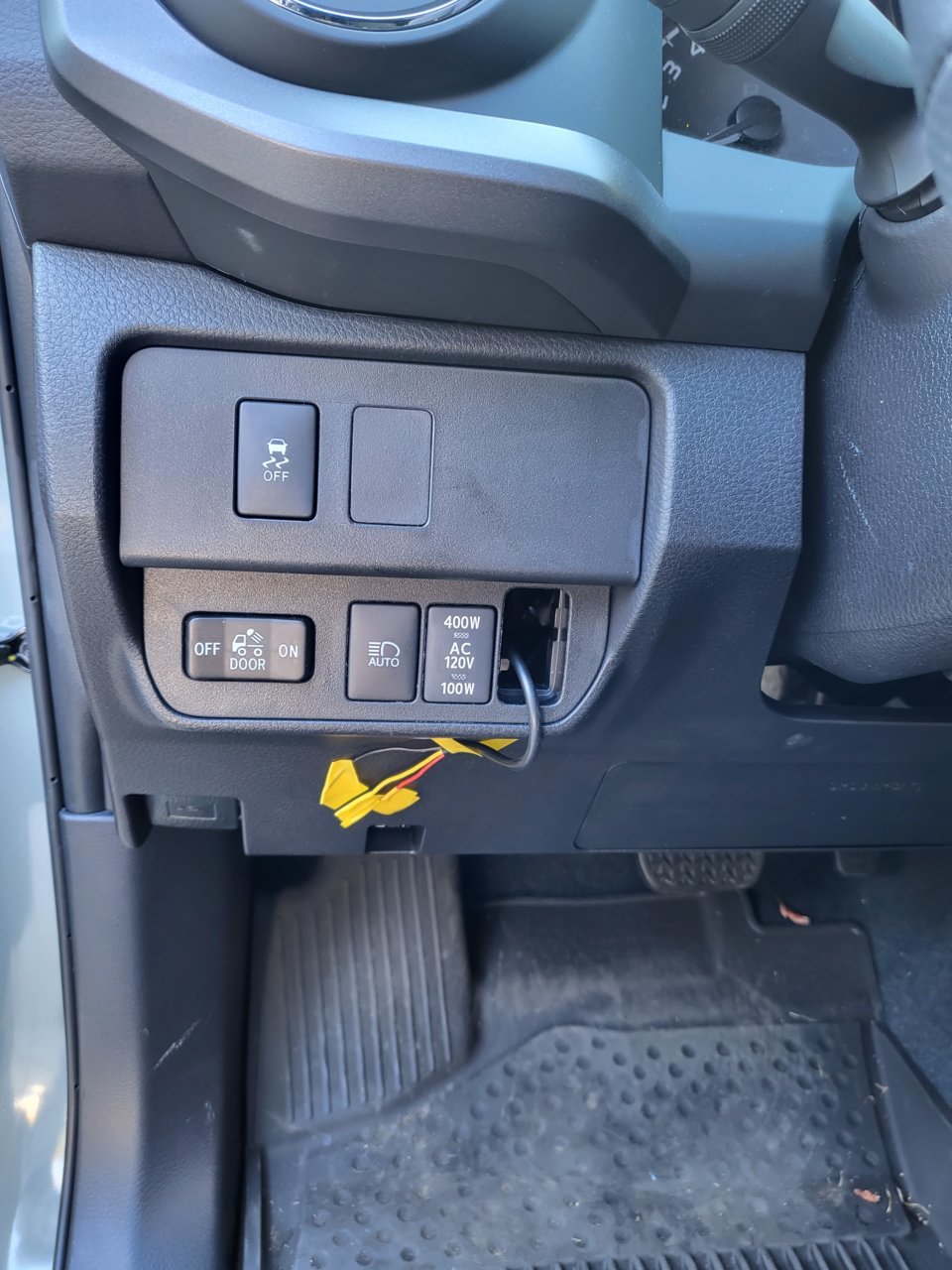

    Hi All,
    My first time on. Can someone help me find a link, or a description?? I am installing after market fog lights on my Bull Bar. I purchased a Nilight rocker switch (Amazon $9.00), not realizing Toyota changed the size opening for 2023. So my switch (a 5 blade) with backlighting is too tall and will not fit into the opening.
    I am having difficulty finding a rocker or push switch that has backlighting and will fit in the smaller opening.
    Help finding a thread or link to some switches would be appreciated. Thanks for taking time to help. I have a 2023 TRD Sport.

    Some pics of my conundrum...

    fortunately, toyota only has a couple variations of switch.
    this version is for the larger opening in your dash
    https://www.amazon.com/WeiSen-Switch-Backlight-Connector-4Runner/dp/B07WDVYCKL?crid=6R62K92R1RVC&keywords=toyota+fog+switch&qid=1696128384&sprefix=toyota+fog+switch%2Caps%2C159&sr=8-1
    this version is for the smaller opening like your auto headlights, or for the other side underneath the heating/cooling controls
    https://www.amazon.com/Nilight-Connector-Replacement-Highlander-Warranty/dp/B0BTBT1M35?crid=6R62K92R1RVC&keywords=toyota+fog+switch&qid=1696128384&sprefix=toyota+fog+switch%2Caps%2C159&sr=8-3&th=1
    alternatively, if you're looking for a more specific resource, or specific switch text, air on board is how i learned all the different sizes-- you'll be looking at their 800 series, with the smaller version being their 900 series.
    https://www.aironboard.com/
    start here, and on the left side, go to 'toyota model' and select 'tacoma 2012-ON left'. 'center' is going to be the smaller version.
    https://www.aironboard.com/online/products/switches/toyota-push-switches.html

    Thanks everyone. Another question. I purchased an Auxbeam foglight set that came with everything, harness, and switch. I wanted to have the factory look switch, so I did buy the one from Aironboard.
    The harness is a 3 wire: black, red, yellow.
    The switch is a 4 wire: black, red, blue, green.
    I wired the black to black, red to red and yellow to green.
    Everything works, but the light for the switch remains on instead of going off when I shut everything down.
    The blue wire from the switch (instructions state to wire to dash parking light circuit. Suggests using the cig lighter) If I do this, will it prevent the switch light from staying on?
    Sorry for the simple questions, I am very new to this. Thanks for your help.

    what is it wired to currently?
    did you get the illumination harness previously linked?

    The harness that came with the lights are all installed. Off the relay and into the cab are 3 wires-red, black yellow.
    Not sure what you mean by illumination harness

    the harness in this quote
    it sounds to me like you're using a different wiring harness straight off the battery.

    Ok, here's how my air_on_board switch works and yours is probably the same.
    Red - Power into the switch.
    Green - Power out to relay trigger.
    Blue - Power into switch for back light. Either
    from fuse box or better yet from illumination harness linked below to let you dim the switch with the rest of your lights.
    Black - Ground.
    Wired like this, your indicator light will go on and off with the switch.
    https://guildoutfitters.com/collections/3rd-gen-tacoma-products
    Edit: Back light is the lettering, indicator is the symbol.
