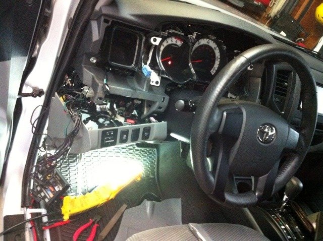

    that switch will not fit the stock fog location.
    regarding room and access to the stock location...
    there is ample room behind the switch. access to the switch is best had by removing the instrument cluster. it can be done from under, but you'll have to pull lower panel as well, and it'll be tight. as shown in this photo of my truck, there is a plastic horizontal piece (under the vent) that protrudes under the stock fog switch location blocking easy access from below.
    if you want to the switch to drop in, like from the factory, then buy the 2012 fog switch... part # 84160-04020 and the fog pigtail sold on ebay
