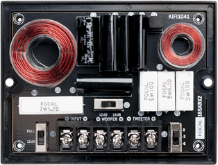

    Hey, just got a set of the Focal 165KRX2 2ohm components to replace my JBL front door speakers. I am curious as to what a couple of the crossover settings do exactly (the manual doesn’t really explain..)
    In the photo below, you’ll see 3 switches:
    -Left FULL or 12dB
    -Top 12dB or 18dB
    -Right 0, -3dB, -6dB
    I understand the right switch to be Tweeter Level, but I am confused how to set the other two...

    In the manual,
    “Tweeter adjustment
    The tweeter level adjustment is made
    on the right of the terminal through
    the 3 positions connector (pic. L). Two
    internal adjustments are possible; the
    first to increase the extreme treble,
    switch up (pic. M.1) or a linear
    response, switch down (pic. M.2)
    and the second to chose the tweeter
    filtering slope in 12 or 18dB/octave
    (pic. N).
    Midrange/woofer adjustment
    On the crossover left part, a connector
    enables you to choose to filter at
    12dB/octave in low-pass or not to
    filter your woofer (pic.O).”
    So the way I understand this:
    The middle switch adjusts how steep the roll-off is on the tweeter high pass filter, and then left switch allows you to apply a low-pass filter on the mid-bass driver if you wanted to send signal to your sub..

    Thats a nice component set, but one of the most confusing translations. I think Focal is trying to include some basic crossover and EQ adjustments for people who aren’t doing active crossovers with sound processoring yet. From the description, it sounds like:
    Pic M.1 is a built-in treble EQ setting. Extreme treble probably gives that familiar exponential EQ setting we’ve all used from 8k (or wherever) to 20k, creating a bright treble tone. Linear treble is literally straight line eq from the 8k to 20k.
    Pic N is your slope between the tweeter and woofer. I’d probably go with 12 dB for a gradual rolloff, but 18 bB will be the safer setting to avoid blowing the tweeter. Not sure why they are offer this option.
    Pic O is a slope setting to help protect the woofer in the set, not to direct frequencies to a separate subwoofer. They are allowing you to do a 12 dB roll off to the bottom of the woofer’s response. The set’s low freq response is probably around 55 Hz, but you would usually crossover at 80 Hz and use a 12 , 18 or 24 dB slope for a gradual filtering to protect the woofer.
    I’m not fully certain and just going off that description. Would check some audio forums and see what suggested settings others are using.

    Ah I see, well seems like a good place to start will be Linear on the Tweeter, with an 18dB slope and a 12db slope on the midrange. I’ll experiment from there. Thanks!

    I'd recommend using any kind of angled mounting cups that they may have come with to mount them on the sail panel (triangle panel opposite of side-view mirror mounting location), and aim them toward head-level of the front-seated occupants.
    Then you'll probably be happiest with either 0db or -3db on the tweeter level adjustment... most likely -3db. The acoustic response you get from the stock mounting location of the lower door speakers in our trucks makes it very easy for them to be overpowered by the tweeters in either location. 0db would likely be too bright for most people.
    I'd go at 12db on both x-overs to start. This will give you the best image height (supposed to sound like the front stage is directly in front of you, not below). If you feel like the tweeters sound "muddy" at all, switch the x-over adjustment to 18db. If you feel like something is lacking from the lower speakers, switch it to full. A lot of people mount those crossovers in the doors. I would recommend taking the time to make arrangements for them to be mounted elsewhere, perhaps in the kick panels or under the front seat(s). This will make it easier to experiment with these adjustments until you are happiest with the sound. Mounting x-overs in doors is also generally inadvisable due to the moisture that can collect in the doors during wet seasons.
    Hope the install goes smooth and you end up happy with the sound you get!

    The other thing that you'll want to consider is that the OEM JBL system is actually tuned specifically for those speakers which you are replacing. They do all kinds of crazy shit to get the most "bang" for their buck in OEM amplified systems. The sound response that your OEM amplifier will output to those new drivers may be very hard to work with & get sounding right. Also, I could be mistaken about this, but I thought the JBL speakers in our trucks are 8ohm drivers? Replacing them with 2ohm may cause issues with the OEM amplifier. Or, if you're lucky, the OEM amplifier is built well enough to where it won't have any real problems and just increase your output wattage. Either way, you may inevitably want to consider replacing your head unit & amplifier... assuming you have not done so already.
    One last thing to note: @mbrogz3000 mentioned that the woofer low-pass filter is there to protect the woofer from playing frequencies lower than (estimated) 55hz. This is correct of a high-pass filter, not a low-pass filter. The low-pass filter here will stop the woofer from playing frequencies above a certain level (which should be specified in the manual), tapered off at a 12db slope when turned on. When left off, the woofer should play full range all the way up as high as it can go, which will overlap with the tweeters response. In some cases, this can be advantageous, but especially if the tweeters are aimed and crossed over at the 12db slope, full-range should not be necessary in our trucks; the 12db LPF should be great.

    Yes, I will be installing the tweeters in the stock location, as I really want to keep everything to appear stock.
    Will definitely be starting with 12dB on both slopes and 0 on the Tweeter. Will test for a while with the door panels off, them button up the crossovers in the door. I really want to try to avoid re-routing the wiring.

    Woofer Slope: 12dB (Full)
    Tweeter Slope: 12dB
    Tweeter Level: -6dB
