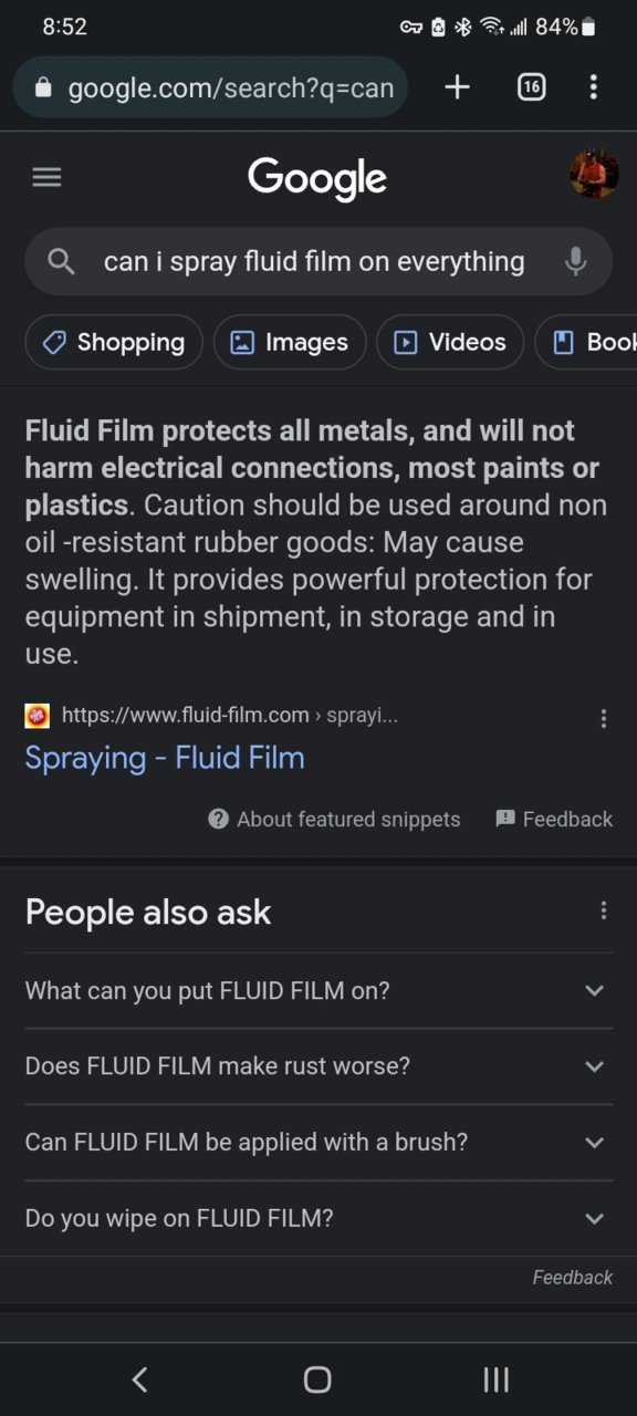

    FluidFilm website says to keep it off certain foam rubber.
    I avoid getting it on the door seals for that reason.

    That is exactly what I saw on their page. So sounds like one could more or less… “Spray the ef out of everything!” :)
