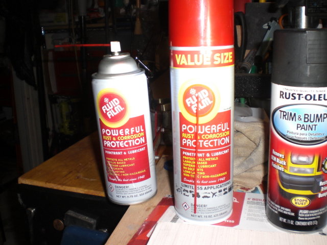

    I would not use fluid film on painted metal.
    I would clean that up .....rust convert....and two coats of chassis specific paint.....
    I use the FF inside the box rails......and I use a lot of it....
    JUst went and bought a can today......wally has it in the bonus size for 9.97.....15oz...
    I also use it on bolt heads.....and exposed threads........especially on non oem cheap ass parts......
    Its advertised as lubricant.....that's also a solvent ......just like wd-40.....
    only worse......wd-40 evaps away....the FF just sits there and eats.........
