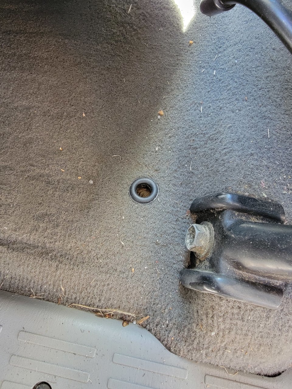

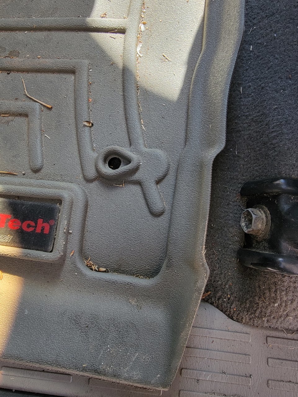

    Where can I find a replacement? OEM? DIY? Member made? I'm tired of my drivers side slipping and sliding.

    You’re just missing the part that hooks to the floor? Bet you could make something to work.

    I just made one.
    The OEM replacement part, IF it's even available any more, is probably $30+.
    If you have enough of the plastic hook left (mine broke off where it pops into the hole in the floor), I just drilled a whole in the end of it, and drilled a hole the rest of the way through the floor. Obviously seal the hole with silicone, but it's been working that way for like a decade.

    Mine didn't. Bought direct from Weathertech. Maybe I can get them to cough one up.

    Mine are slick on the backside.

    Mine was missing entirely when I bought the truck.

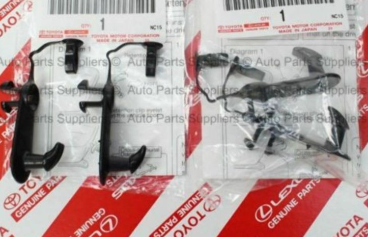

    The original was discontinued and revised by toyota. Can't recall specifics but it was that safety issue / sliding floor mat thing. The second definitely looks like the original but the current design I believe are similar to the first with that locking tab piece.
    Why I love the Husky mats. Those teeth on the bottom don't let that thing slide anywhere - no need for a retainer clip.
    EDIT: Found some images...
    Original -
    Revised -

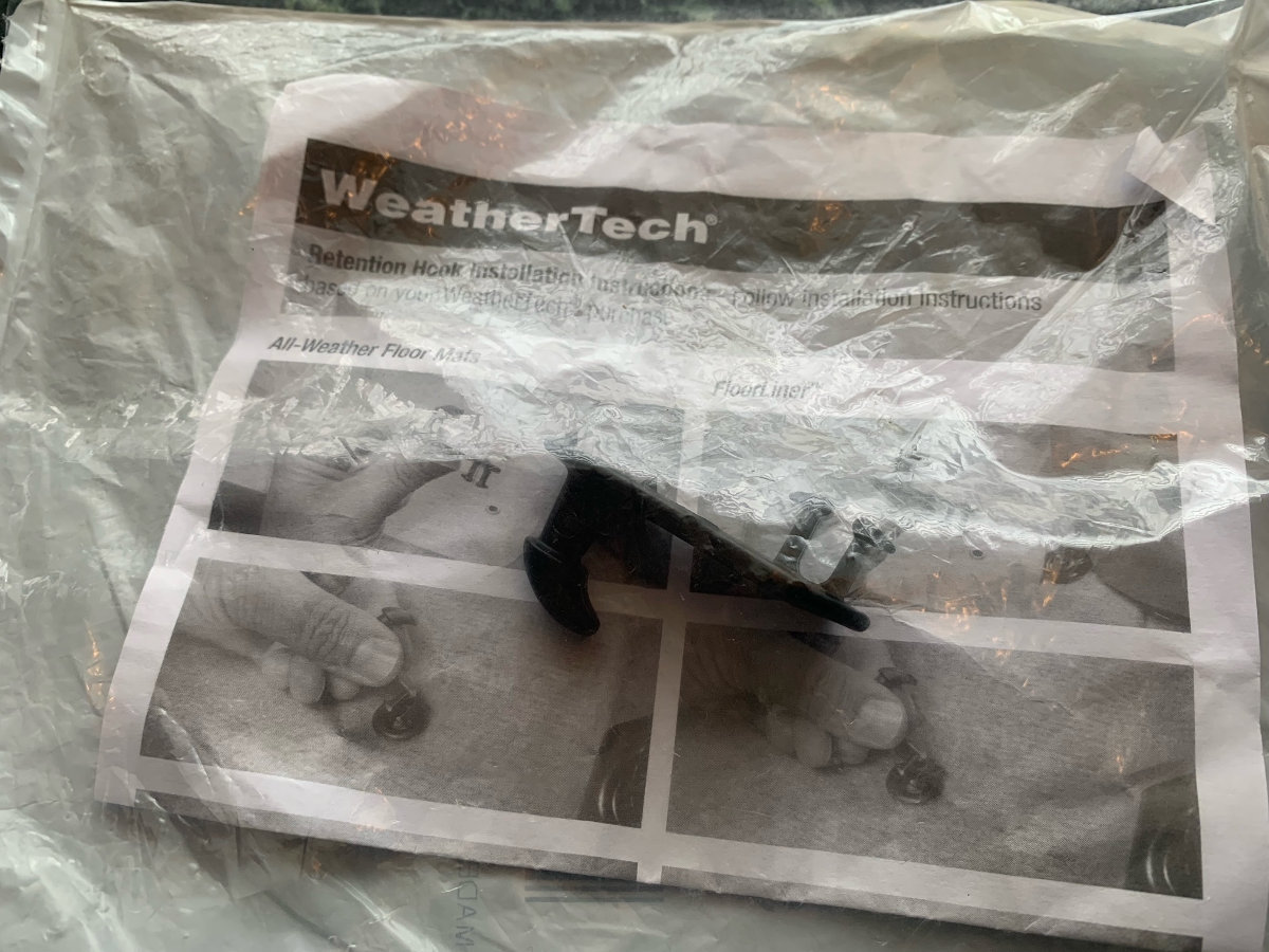

    They don't have any means of gripping a factory carpet, no. But they do come with a replacement hook/clip. At least mine did for every vehicle I bought them for.
