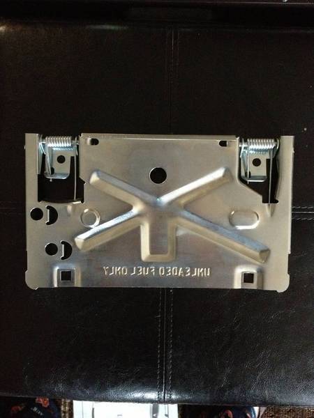

    This is pissing me off!! I bought a license plate flip up/down bracket and it makes no sense how the hell to attach this thing.....Im so damn confused. First off there are springs on this thing that I dont understand what loads them and how that works. The top holes where the springs are dont line up to my bumper and if I used it like this it just dangles and my license plate would be swinging back and forth hitting my bumper. Also I know a ton of yall have Bruteforce rear bumpers, how did yall mount yalls tags w the hidden hitch. The plug as well makes my license plate stick out. Please post lots of pics as how you mounted the plug or license plate bracket and how it all works together.

    I had to drill my bumper for that holder. The 2nd pic is how it should go on. The lettering for the "unleaded" fuel bit will be backwards. The springs will work when bolted up and the lic plate assy will flip up from the bottom. You will need to test fit the swing so you can locate the drill holes right in the bumper and it doesn't jam. I painted it black so it doesn't stick out horribly. Make sure you use a nylock nut or some anti rattle off hdw. Cheers.

    In the second pic is the long wire attached to the spring supposed to go in that notched area so there will be tension on it when flipping the license plate up?
