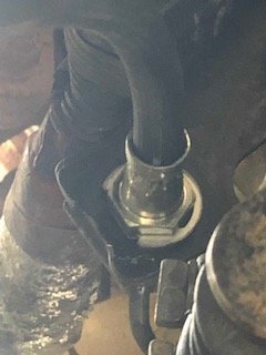

    I have a clutch fluid leak on a 2000 Tacoma V6 manual transmission. It is leaking where the flexible hose attaches to the hard line to the clutch release cylinder. I tried to unscrew it but it is supper tight similar to a rusted brake line. I sprayed it with penetrating oil but no luck so far. Any ideas?

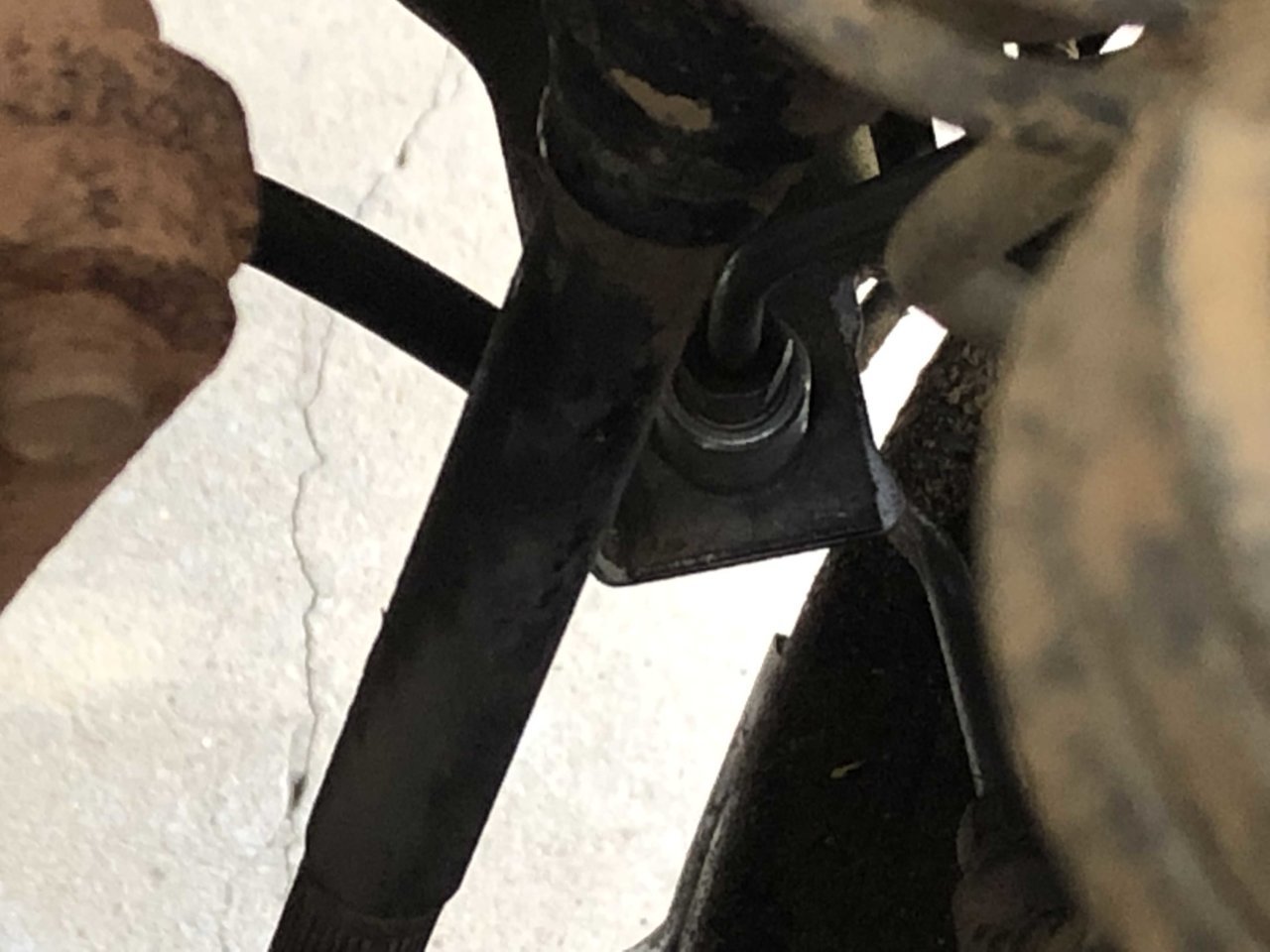

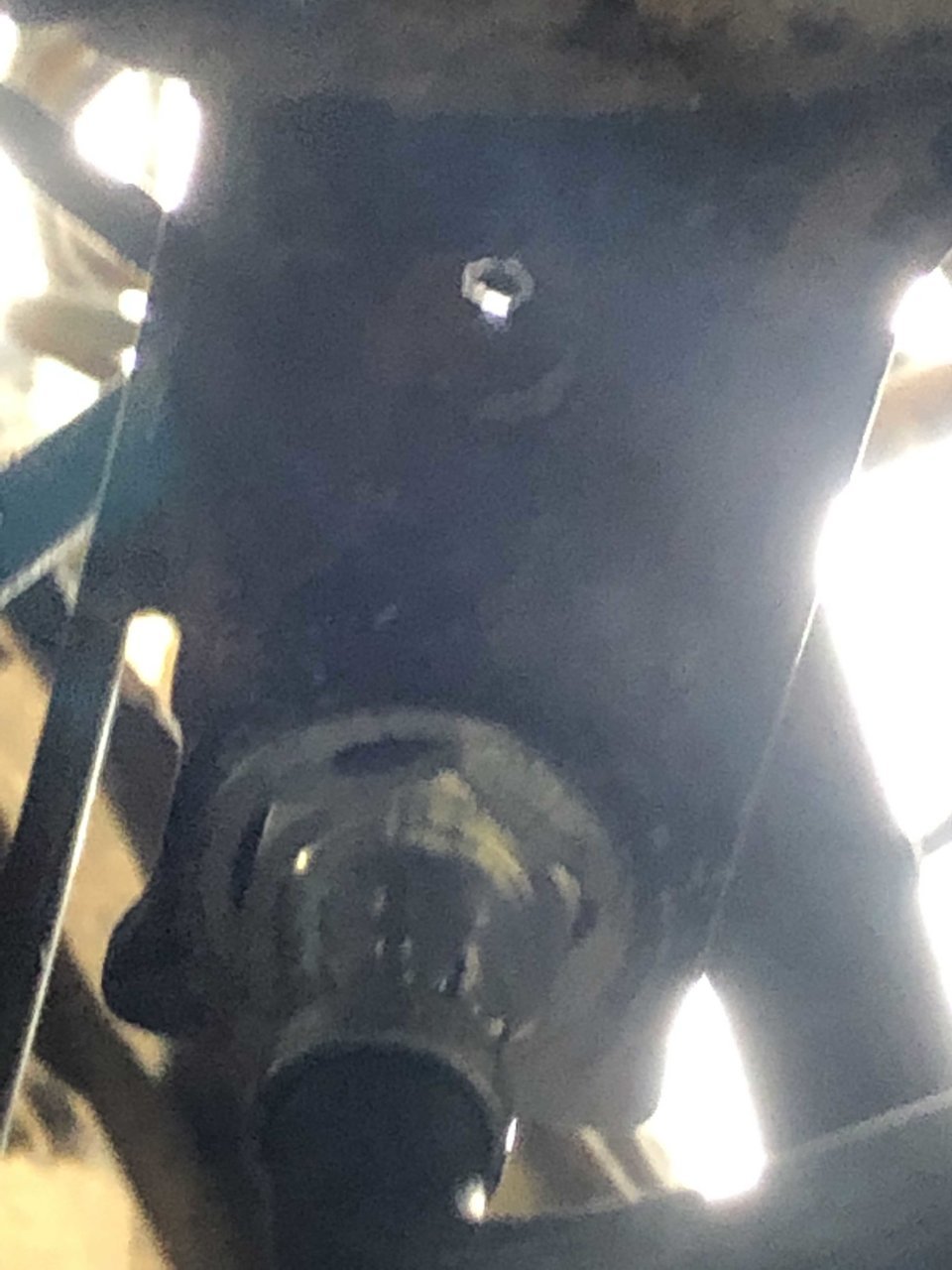

    I took it to a mechanic and here is what I see he did to fix it. The flexible hose doesn't unscrew from the bracket, the metal hydraulic fluid line is screwed directly into the hose at both ends. Therefore you have to unscrew the metal preformed lines from both ends of the flexible hose similar to brake line fittings (the small 10mm or something). I don't know how it actually comes loose from the two brackets. Looks like he drilled out the top one and added a custom piece of plating to hold it in place.
