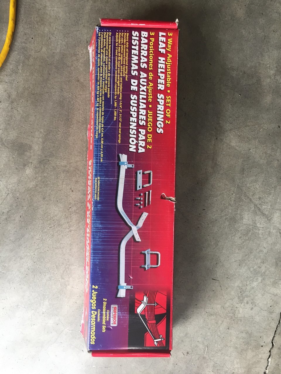

  12. Mar 4, 2018 at 1:19 AM
    OregontoBajaCA
    OregontoBajaCA Well-Known Member
    Dec 6, 2017
    #237812
    819
    2017DCLBOR
    As has been said, AAL or airbags are best for additional load carrying capacity and to keep your rear end from sagging.
    I don’t want additional lift in the rear causing greater rake of the truck while unloaded.
    I tried helper springs many years ago but removed them after a while in that they weren’t helping with the need to lift and carry additional weight for cargo and towing along with providing clearance for large aftermarket tires.
    Air shocks did the trick for lift, clearance, capacity and a smooth ride on that vehicle.
    These cheap aftermarket helper springs worked perfectly on my Tacoma to bring back some arch in the springs as mine were also lying flat on the overload leaf.
    I initially had them installed with the included pins in the holes past the clamp for the highest load setting but I think that changed the pinion angle and I noticed a slight vibration while driving because of too much arch at only the front of the springs.
    I removed the pins and reinstalled them at the lowest load setting and they are functioning well to bring just a bit of arch to the leaf pack so that the overload is not touching while unloaded.
    The ride is great.
    I notched out the Teflon pad at the front of the helper spring with a Dremel tool so that the helper spring Teflon pad surrounds the stock spring leaf keeper pin.
    Another modification on the helper was to cut the flat metal piece of the clamp shorter at the outer side to clear the passenger side shock.
    These springs could be positioned forward a bit to ride at the center of the helper pad if you wanted.
    These helpers wouldn’t fit at the rear of the stock leaf pack because of a lack of clearance at the driver side shock.
    This company sells a shorter helper that could possibly be installed farther back at the rear of the leaf pack if also desired.
    I believe Helwig sells pairs of leaf spring helpers that are to be used at both ends at the same time.
    For now, this seems to be working great for a cheap and easy fix alleviating the negative arch to bring back height, without creating additional lift.
