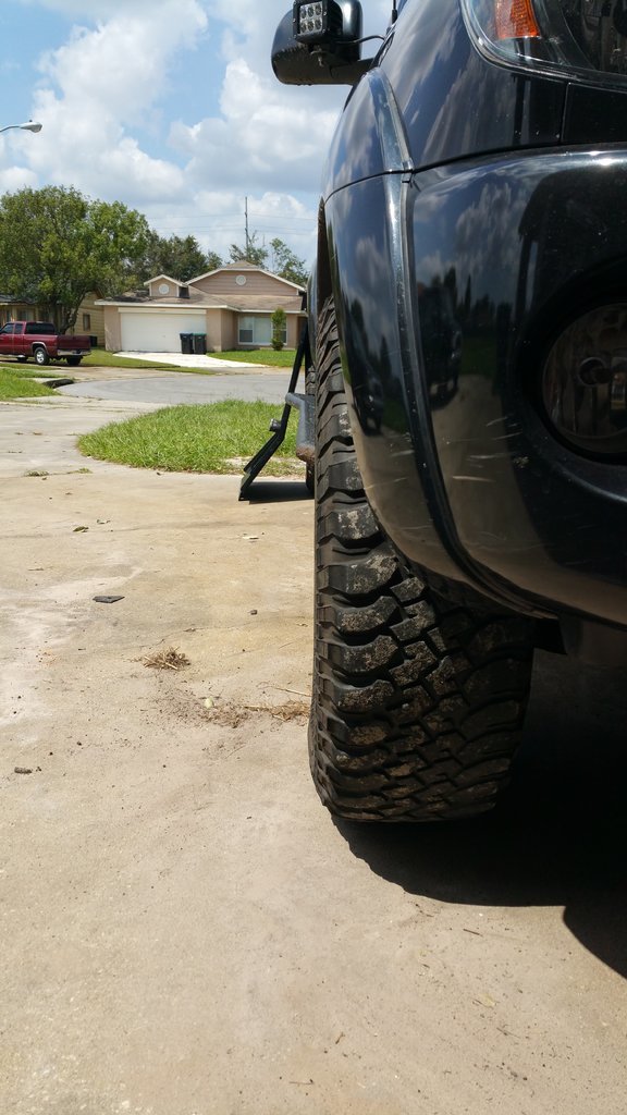

    My rig on FJ Steelies, brought the wheels out nearly perfectly flush with the fenders. Looks bad-ass with 255/75/17 BFG M/T's if I do say so myself!
    :D
    I have 3/4 steel centercaps but don't run them because I know I'll lose them offroad or they'll hold water/sand.
    Only "side" pic I have right now.

    Cool. Do you notice the weight? Or did you when you switched?

    I had the stock TRD/OR alloys with 265 70 16 yokahama geolandars on before I went to the steelies with 255 75 17 BFG MT's Honestly my butt dyno couldn't decern a real difference.
    Sna and I married my tacoma like this.
