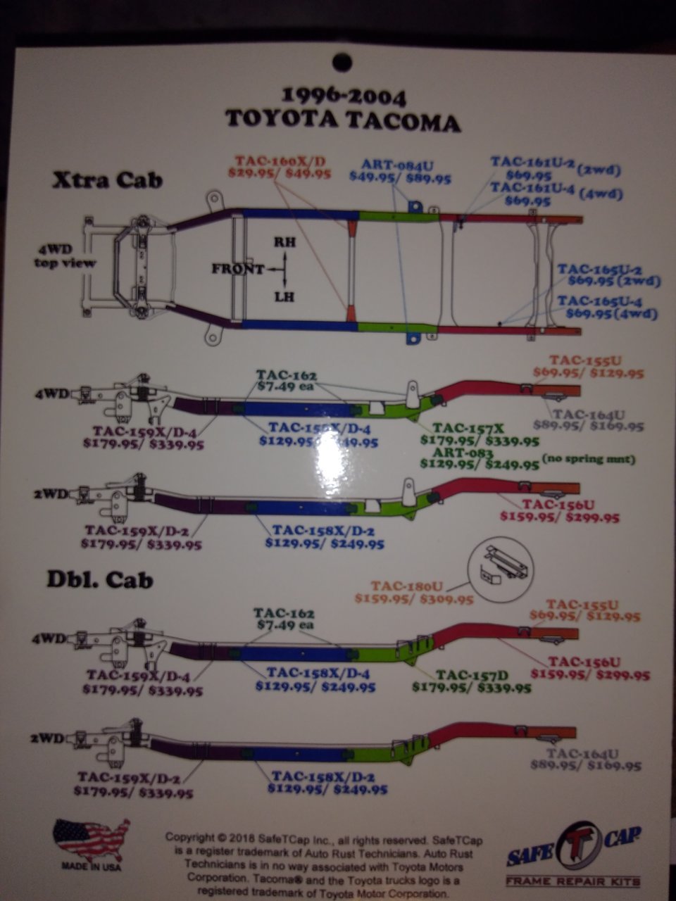

    Upon inspection and cleaning off the old rust guard from my frame I discovered a few issues on the passenger side of the frame; Just in front of the leaf spring shackle mount. I've searched the Forum for some tips and although helpful I feel like every hole is unique and so on... I plan on cleaning up the rest of the frame (which after investigating is pretty good/Just surface rust and the peeling off rust coating). Before I give the frame a rehab i'll have to get this fixed... I don't weld so obviously ill have to bring it to a shop. I don't want to get hosed so i'm looking for advice. Is it bad enough to cut it out and get a section welded in? I'll be calling a few places next week.
    I found this searching through the forums:
    https://www.autorust.com/product/complete-rear-frame-section-w-leaf-spring-shackle-mount-tac-180u-r/
    Here are some photos of the problematic section:

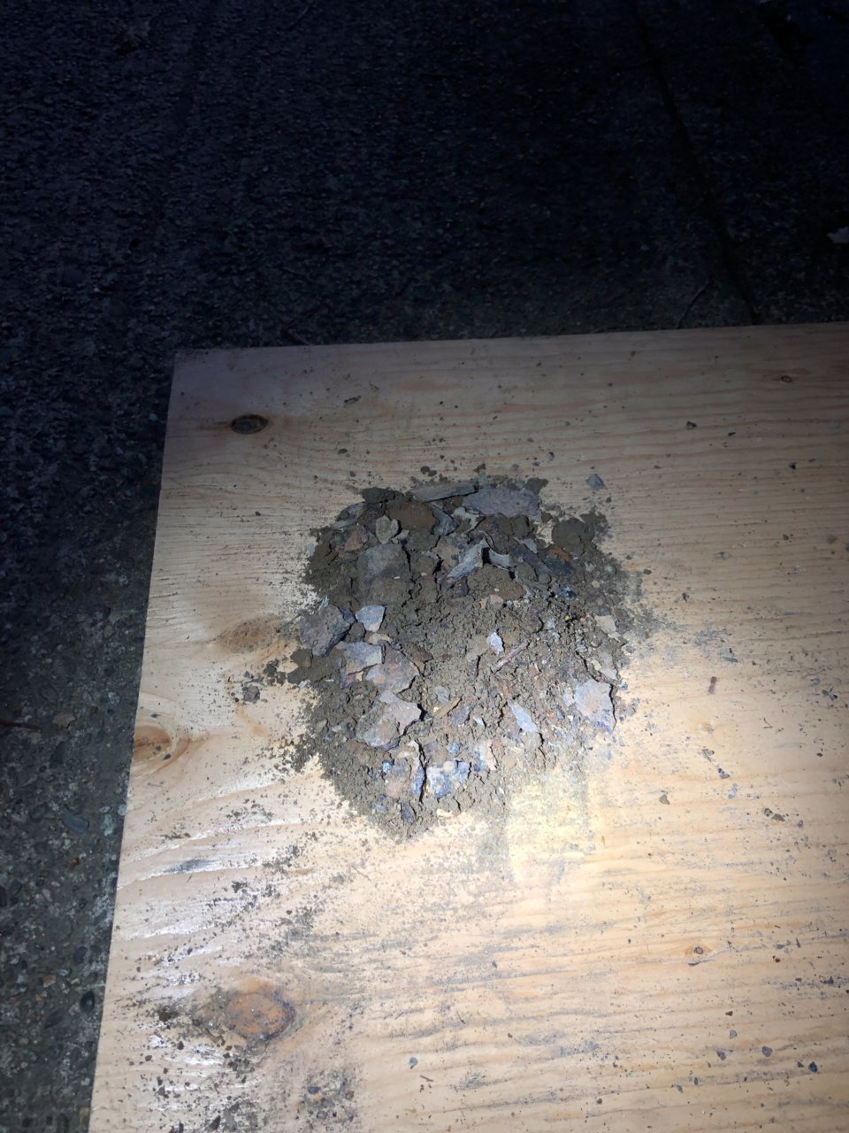

    The rust proofing chipping away on the right side of the photo, not a crack. This is after some heavy wire brushing and some hammering. A little late in the day for power tools.
    Wire brushing no hammering on this section.

    i am wondering if that stuff was sprayed over the top (under) of the rear frame small drain hole, maybe why those are so big now?
    and trapped water, etc. inside to pool up

    Very possible. I pulled out a lot of very dry dirt from the holes. That could of been trapped in there too. Who knows.

    Enclosed areas typically rust from inside out.
    A borescope inspection (you can use a camera attached to your phone), beating with a ball peen and probing with a large screwdriver are in order before work begins.
    It would be pretty odd if the other side didn't have the same problem when you investigate further.
