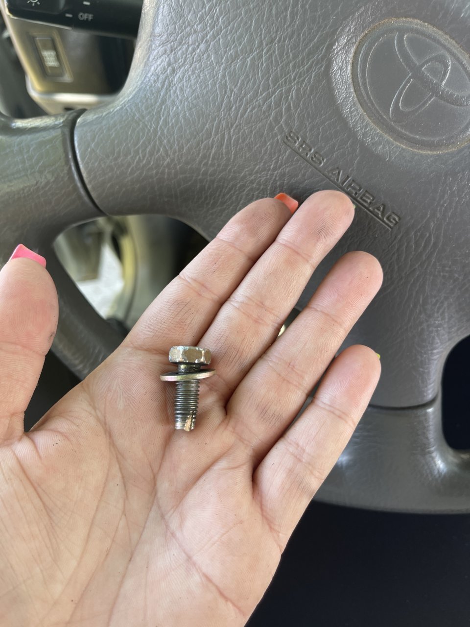

    I was driving along and felt something pop (thinking I just caught my shoe on the clutch) when I shifted gears not realizing at the time a bolt fell from somewhere until I went to start my truck to leave. There is no clear view of where it came from, and when I went to start my truck I was unable to do so. Thankfully I can bypass the clutch start with my clutch start cancel button. I’m just now wondering what I should do or look for to fix this issue and find out if y’all may know how this bolt would have just worked it’s way out of wherever it goes ?
    Thank you for any feedback or helpful tips.

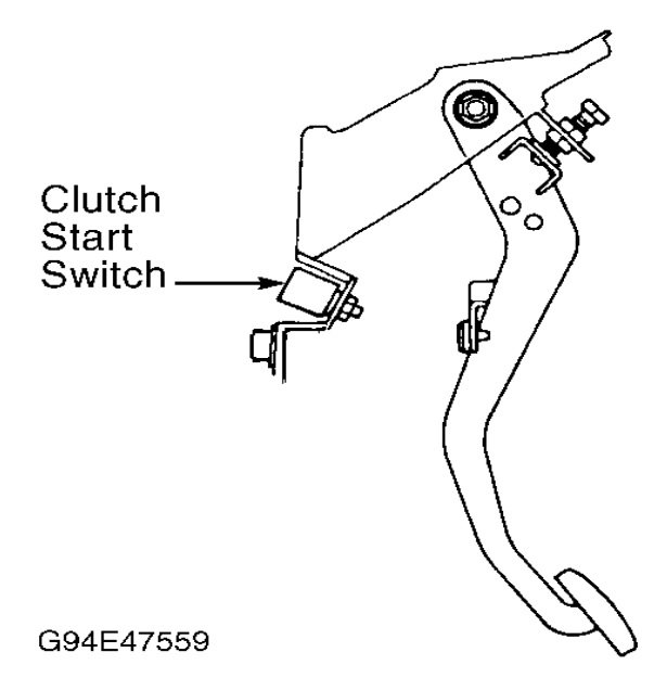

    That's a very common bolt for Toyota's so it could have came from anywhere, since your having an issue with the clutch safety switch I'd start by looking in that area.
    It should be on the firewall side of the clutch pedal bracket behind the clutch pedal about midway up.

    It is also possible it came from the clutch pedal bracket allowing it to move enough the clutch safety switch does not close.
    How it came out vibrations over the years the movement of the clutch over the years who knows it may have only been hand tighten.

    Also possibly from the Glove Box. I had a bolt just like that fall out and found a few years ago. Can't find it now but it went to the top of the glove box because the bolt is missing when I replaced the ECU.

    That is exactly where it came from! I was able to get under there and put it back in and tighten it back up.
