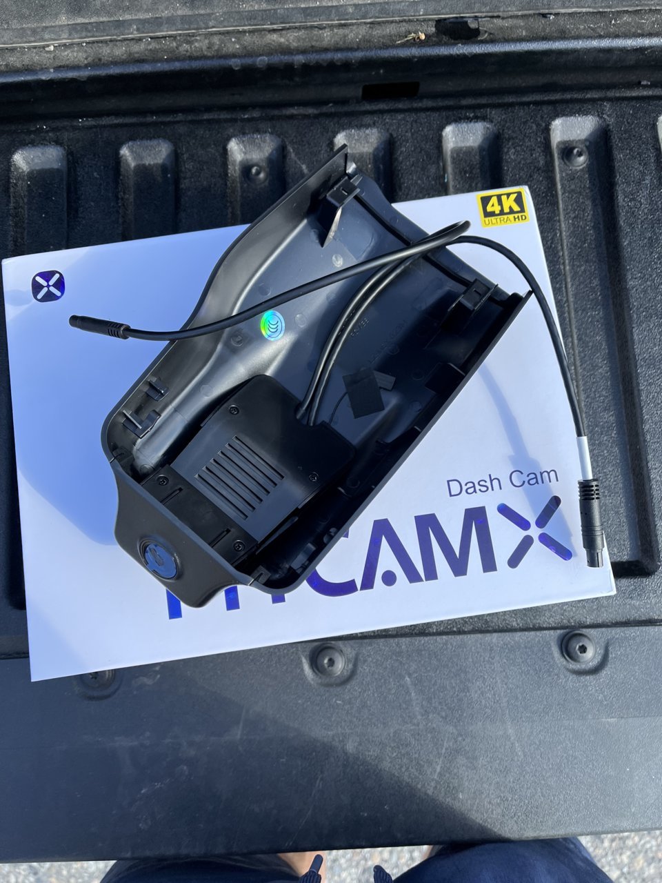

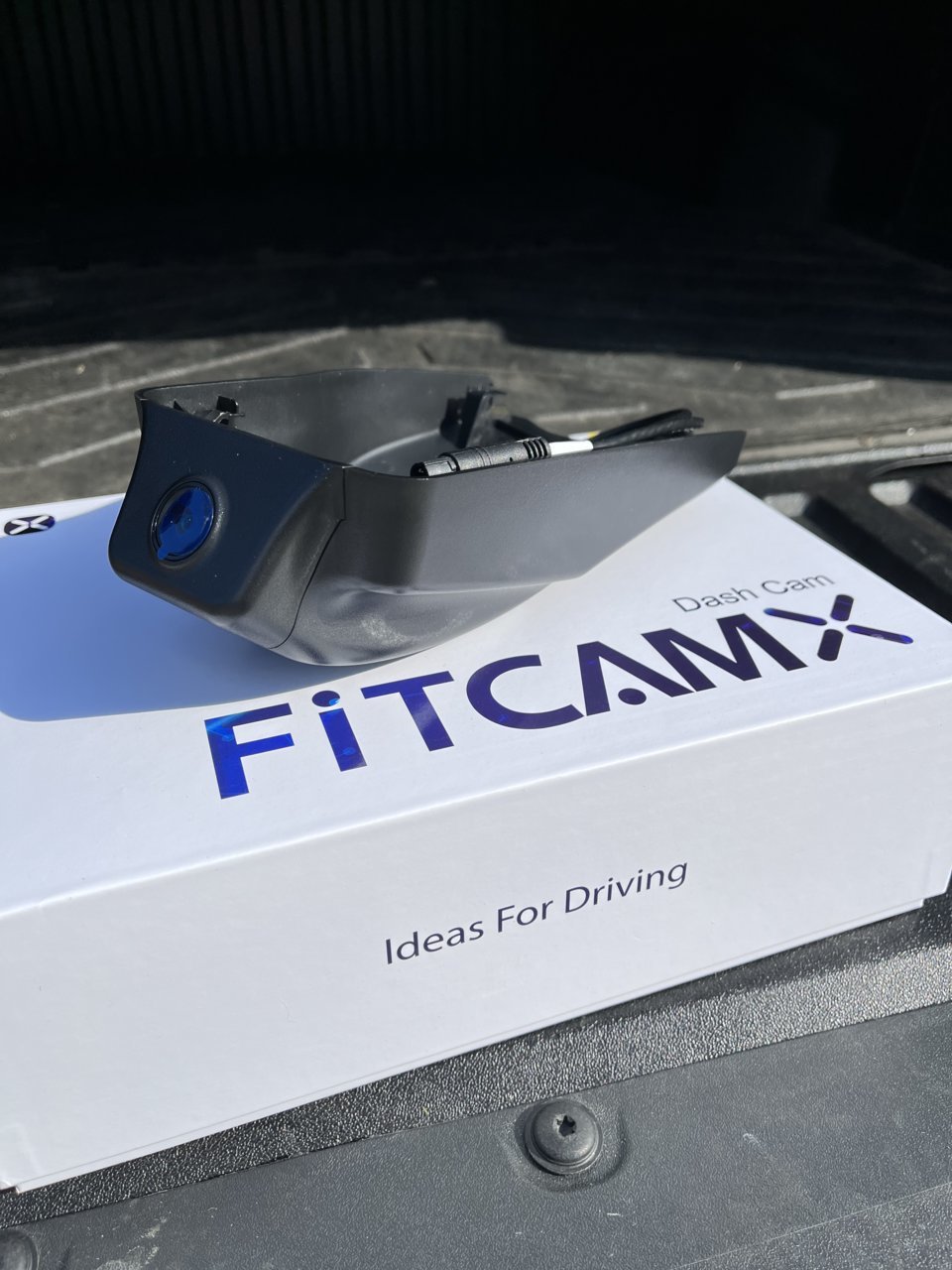

    This is the front camera and housing. The camera itself is built into a replacement for the front plastic molding that sits on top of where your trucks radar sensor/TSS system is housed. This point was one of the selling features for me as the finished install of the camera system looks factory and almost forgettable, which is something I like
    Heres another view of the front camera and housing. One wire is for the front camera plug in, while the other wire is for the rear camera. The wire with the white tape was for the rear camera on my setup

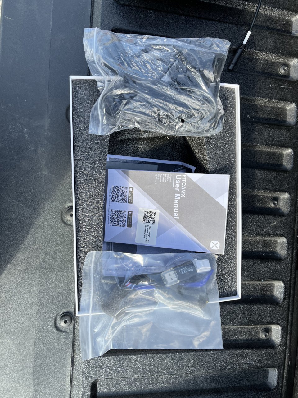

    E30C7A38-D899-4619-A016-391697C40E9C.jpgHeres everything else that came with my order including all the necessary plug and play wiring, rear camera, USB reader for the micro USB used in the camera system, and instructions which were ‘7/10’ easy to follow. There was also a small hand held plastic pry tool that helped a lot when it came time to hide the wires

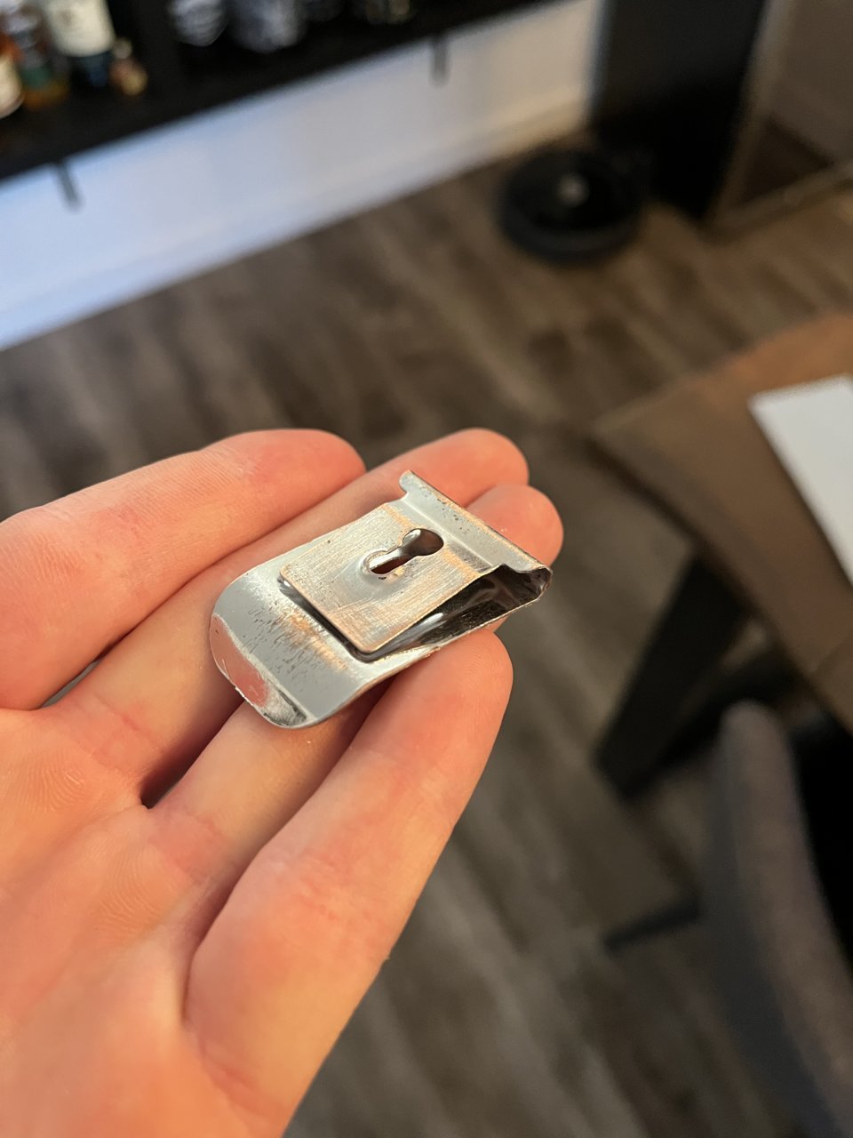

    You will need to remove your stock orange clips and place them on the new camera housing so it can mount to your truck

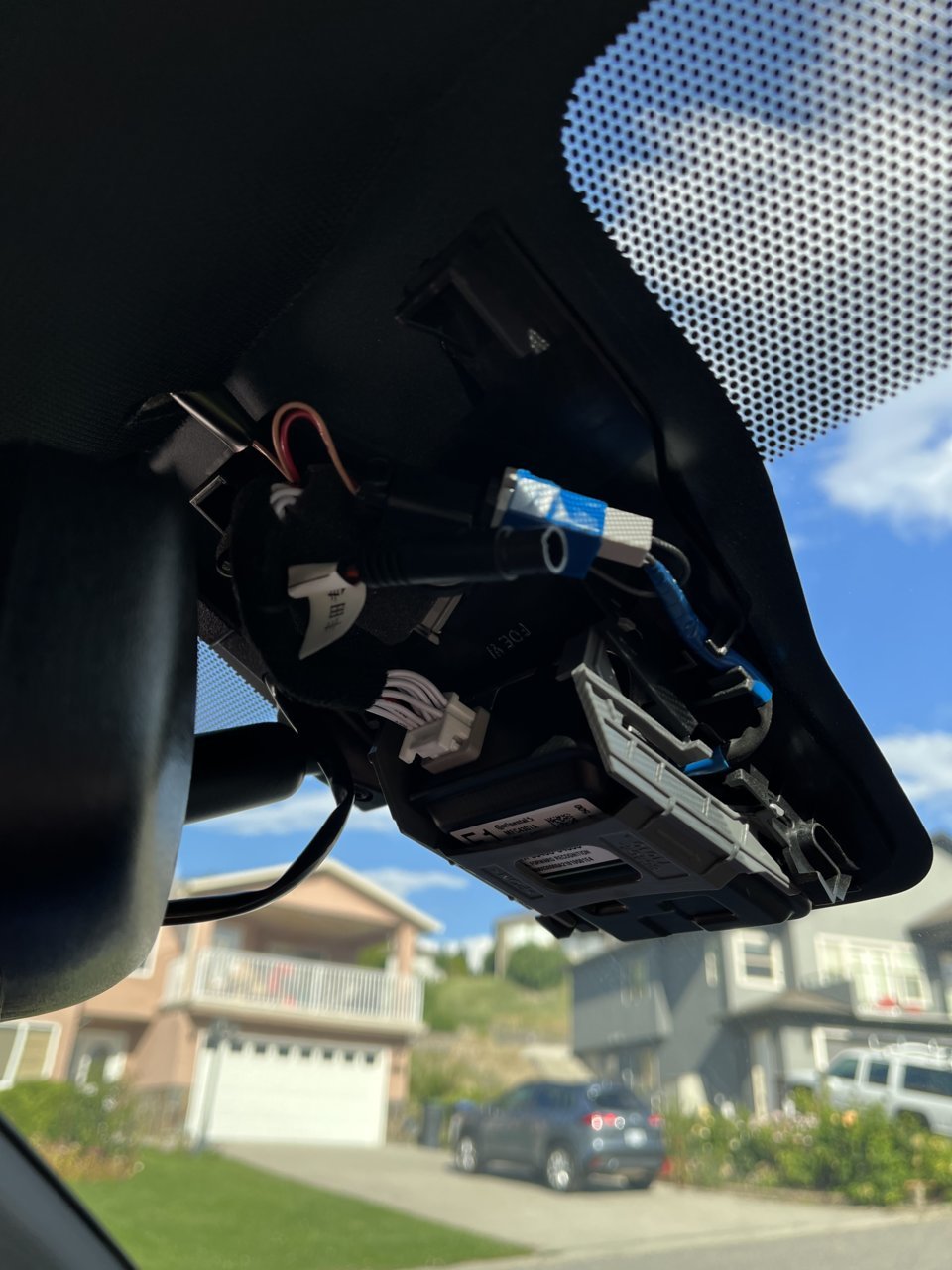

    Heres a look at everything after I had put all the necessary wires together. I added electrical tape to the connections just as an extra measure. If you are saying to yourself ‘wow that looks like a lot of wires to fit in that area’, its because it is. The organization of wires was the part of the install where the instructions fell short. The manufacturer didn't do a great job providing direction in how to organize the excess wire for this system. My recommendation is that after you connect everything up at the front, put as little of the wiring as you can inside of the plastic molding area. I say this because it is super challenging to get the hole thing closed up if theres way to many wires inside the housing. I managed to get just the two connections inside of the housing with little to no extra wires. This is also helpful for air circulation for the unit after everything is all closed up

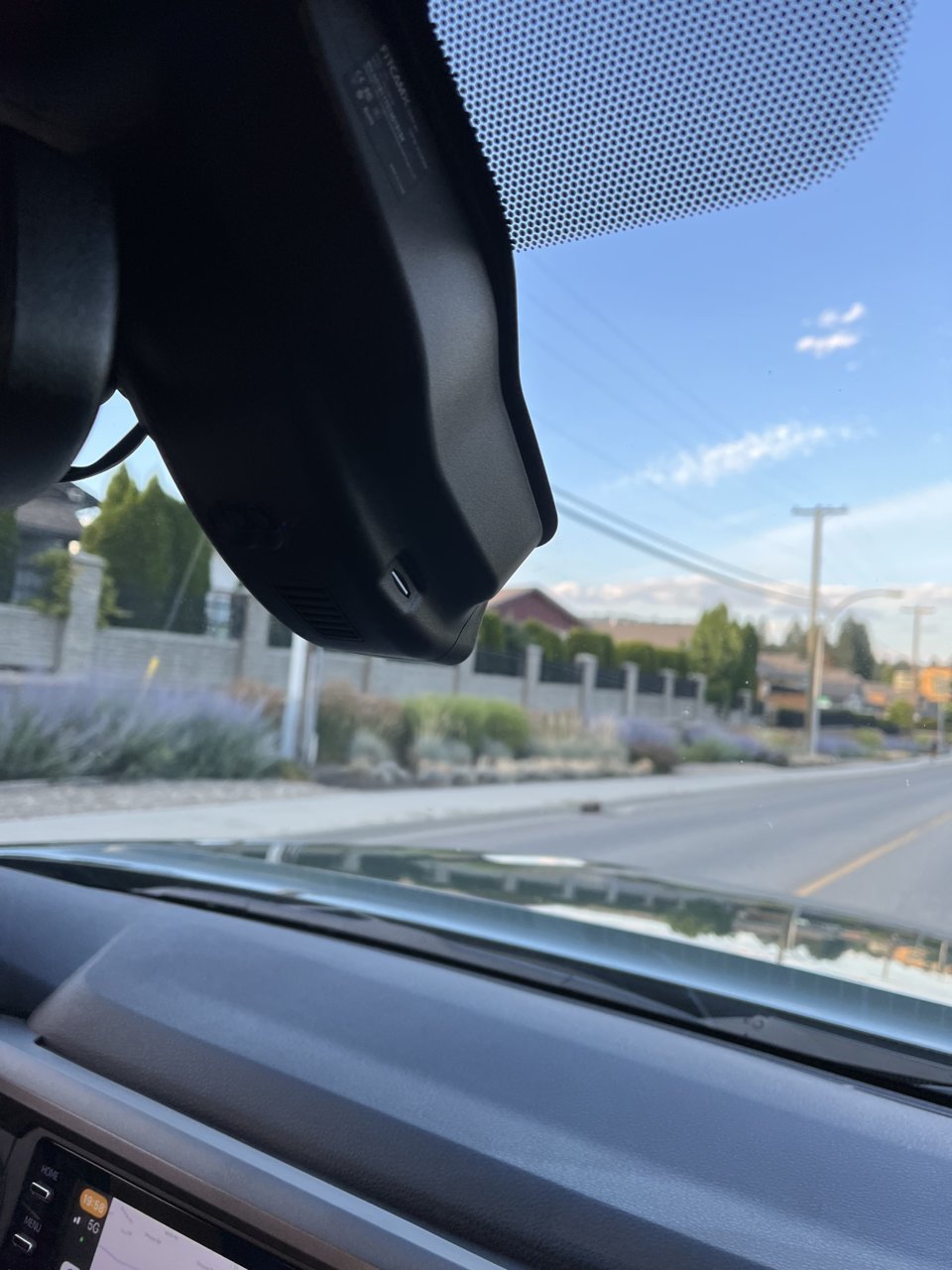

    Here is front camera after everything is all closed up. As you can see, the SD card is accessible on the side. Its not in this photo but there are two buttons on the front face of the housing for capturing still images, as well as a power button. The camera starts up automatically every time you start the truck, but the options there if you want. There is 3 small LEDs as well on the front face the housing that will flash blue and red when recording. Your instructions will detail all this

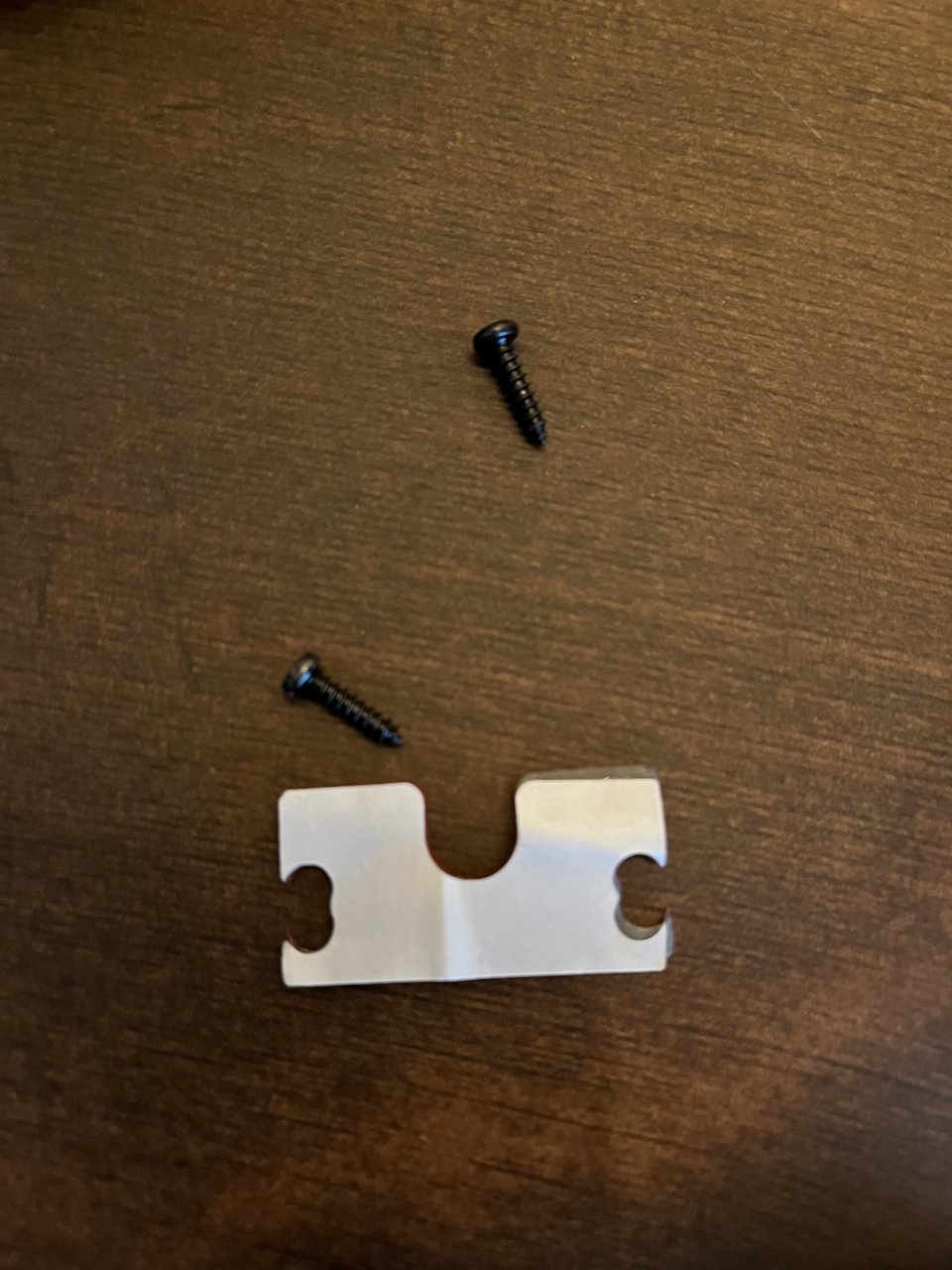

    The manufacture provides you with a sticker as well as a couple screws as pictured above. Now, I don’t no about you but I would prefer to not screw into my 60 thousand dollar trucks ceiling lining in hopes that the rear camera will hold, be straight, and function as advertised

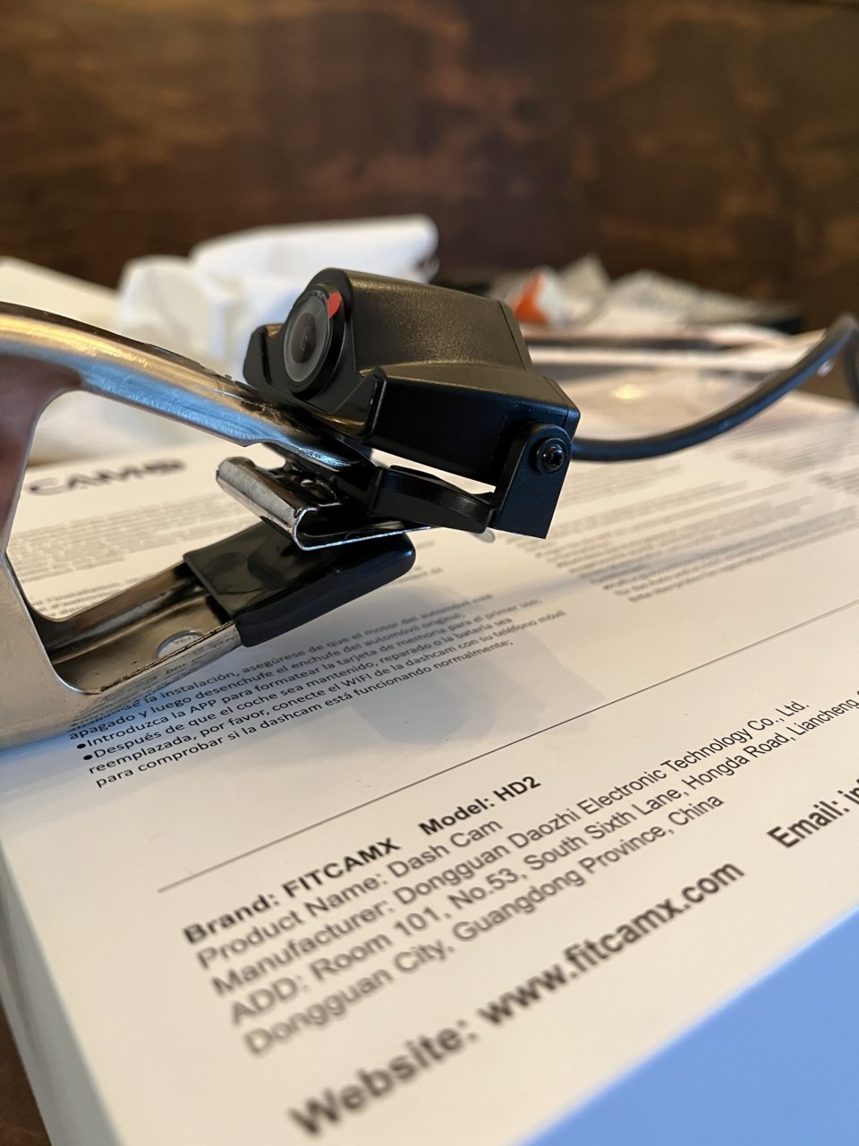

    After some head scratching and pondering the idea, I came up with something I decided would be better for my set up. I took an old measuring tape and removed the belt clip that came with it on the back
    I used some mild grit sandpaper on the two ends that would be connected and used some gorilla glue epoxy to join the two pieces as shown. My idea was that the clip would slide over the end of the trucks rear head lining with the camera attached in a more non permanent/damaging way
    Heres what the rear camera looks like mounted. I personally think it came out great, and the built in ability to pivot the camera up and down gave me the most advantageous angle for the set up

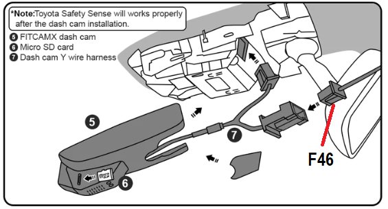

    I wasnt aware of that. Whats the power source the camera is pulling from then to operate?

    All power comes from the car’s battery/alternator. If you notice when you took off the cover, the TSS is it’s own unit.

    I didnt notice which is why I stated in my review above that the power is drawn from that system
    Appreciate the clarification

    Thanks for adding that wiring diagram
    Good information to know!
